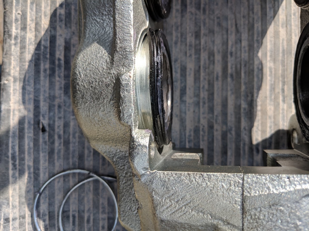

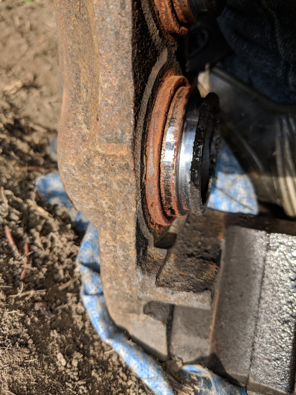

    Realized I cant drive anywhere it was so bad so I called around to find the closest Napa had closed and the next closest one was 40 minutes out. Partsource is 7 minutes. Cardone once again....
    @Exracer2 you were correct in pulling the boot back to grease it.

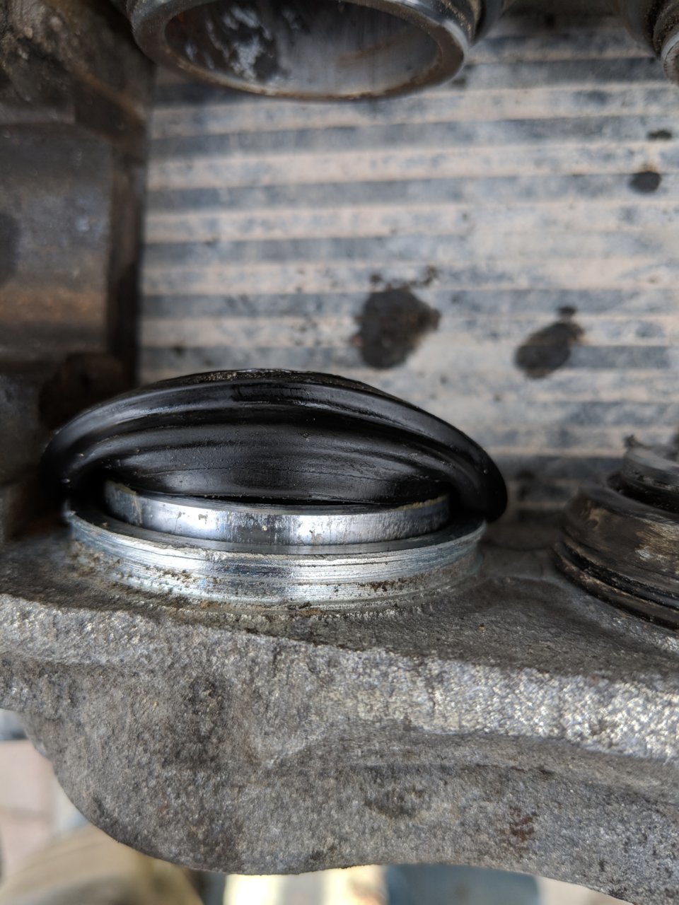

    This is what I found once I removed the boots. Boots were in very good condition.
    So this is what I did to prevent future fuckerry
    Peeled it back and smeared brake lub all around the inside of the boot.
    It made so much sense I decided to pull the other side and do the same
    My question is now is there a chance of cross contamination into the brake fluid as the piston moves and spreads the grease?

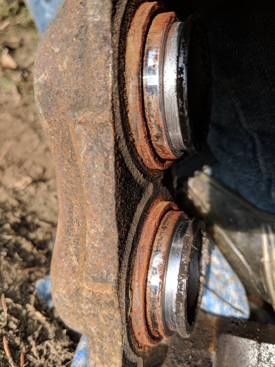

    3 out of 4 pistons were sized.

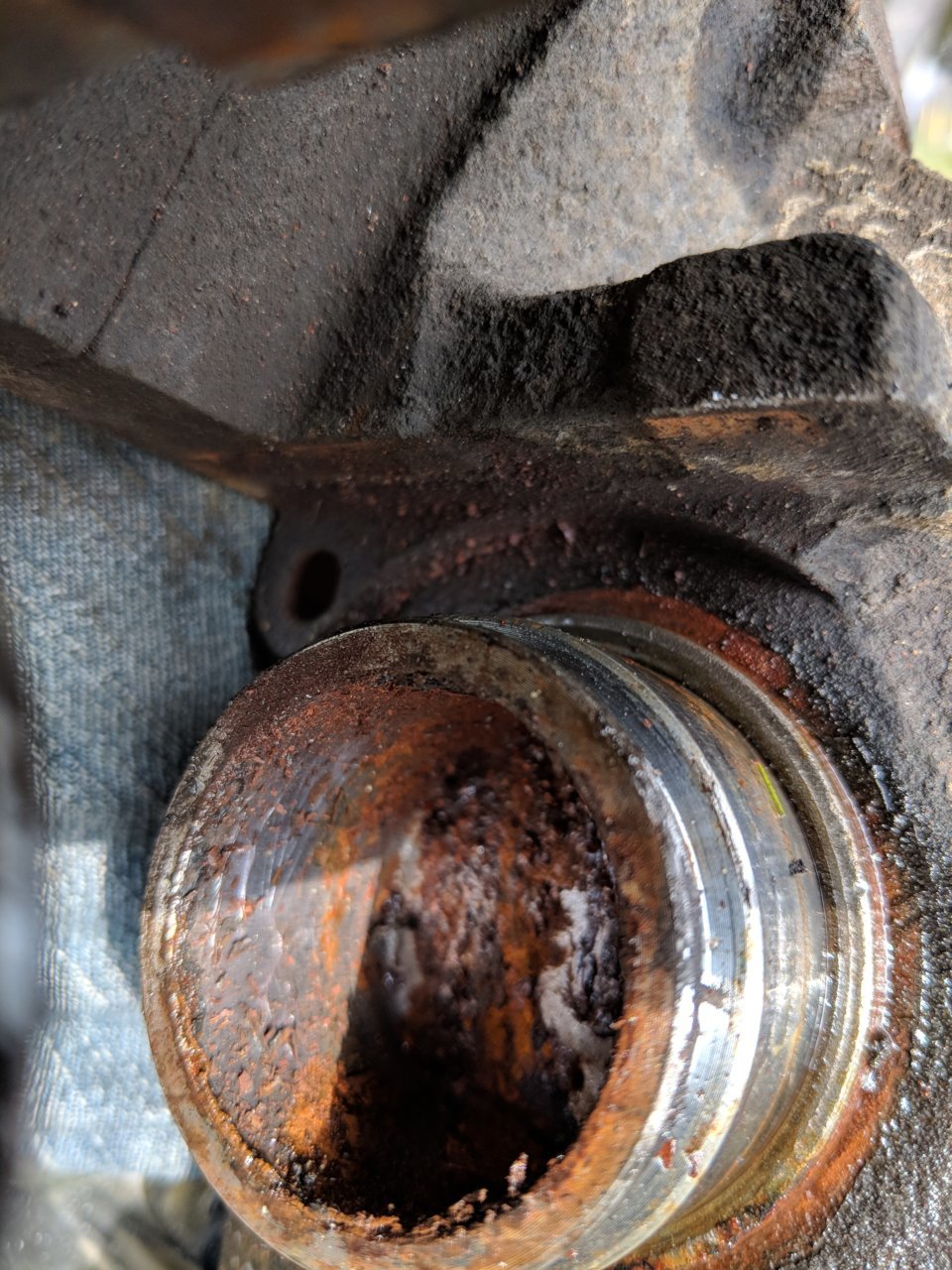

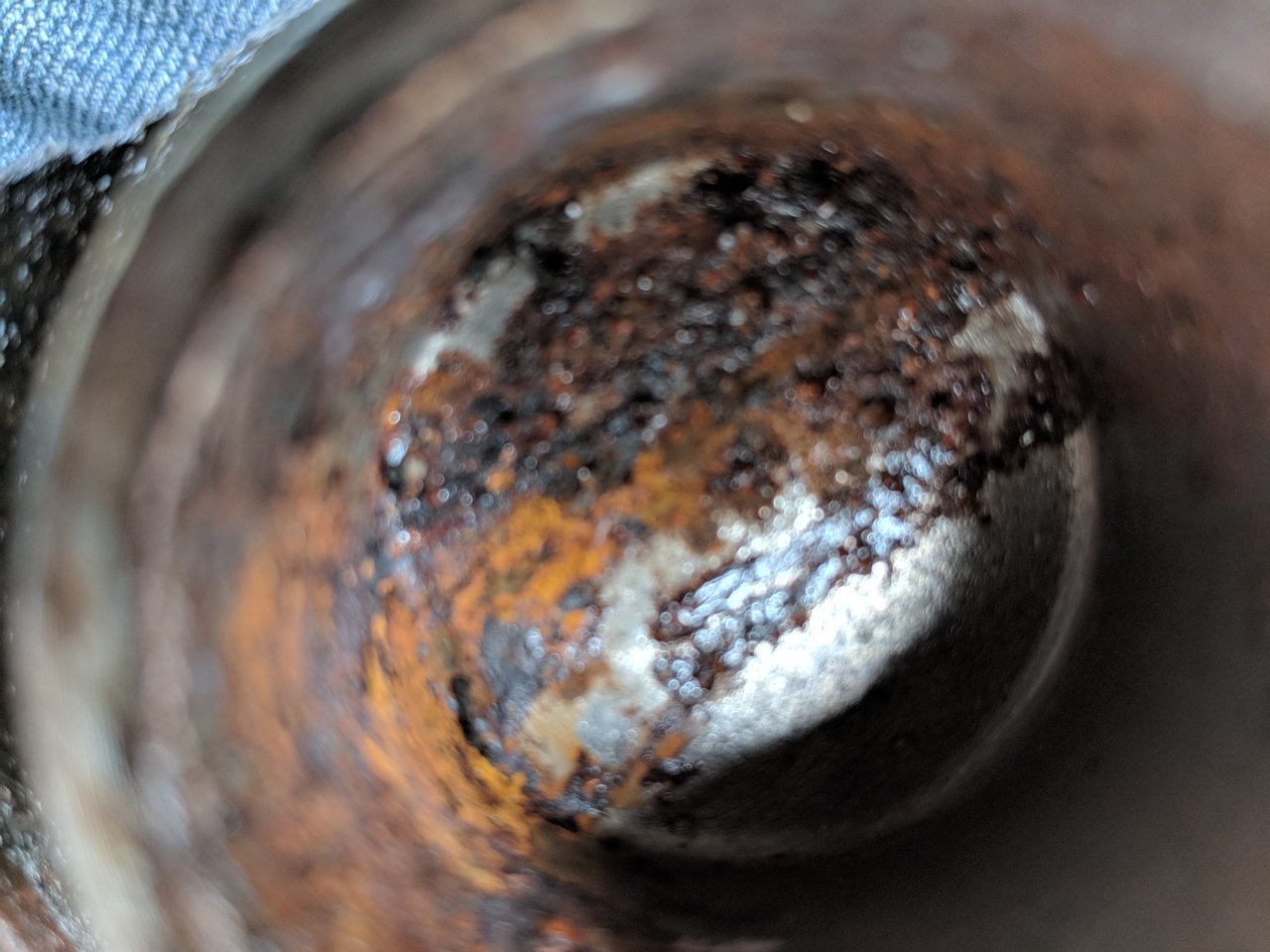

    Oh... Almost forgot... This is why I coat the inside of the cupIMG_20180410_102035.jpg

    The reason I don’t do the inside of the cup is that is only aesthetic. But if the grease (high temp) does melt it can get onto the pads or rotors. At least if you lightly coat the outside of the piston and have good boots it should stay where it is and you use such a small amount of caliper grease that any contamination will be extremely minimal. If it does leak to the pads or rotors you have other issues at that point anyway. Now if you have old fluid and did not flush the system that can be your cause of water rusting the cup. Brake fluid is very susceptible to absorbing water. That is why you never keep old brake fluid that has been opened for long. It would need to be very contaminated and you might notice fluid boiling before that (my experience is race motorcycles and you might not identify or notice it on the street in your truck).
    Now as far as contamination because of the grease I will do my best to explain why it shouldn’t be an issue. Think about what a caliper does. It holds fluid on one side and keeps air from intruding on the other side. Think about the air part of this for a second. I HAVE had a seal failure where the seals hold fluid but air gets pulled into the fluid on the retraction. It is a rare occurrence but it can happen. Either fluid or air passing the seals means they need replacement. Now any grease that does get pulled in past the seals will have to be impregnated into the metal of the cup and pass those seals that hold both air and fluid from passing from one side to the other. For contamination of any value it then would have to then mix with the brake fluid. Think about how little grease would pass if any considering fluid and air can’t pass the seals. Make sense?
