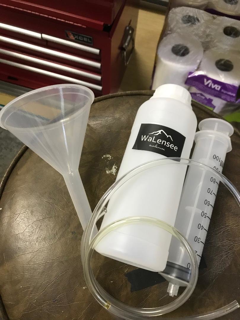

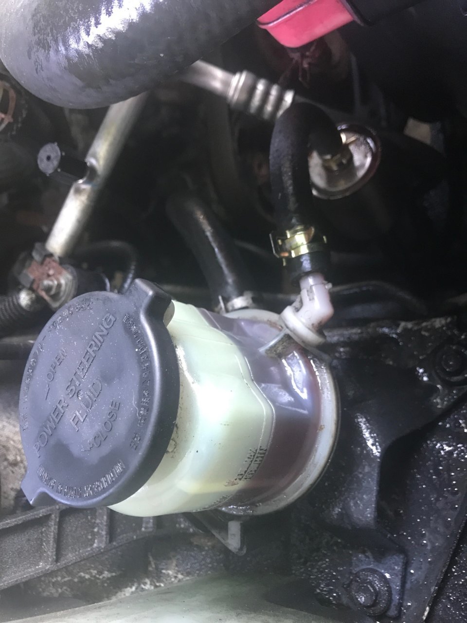

    I did syringe method and did 8 fills. It was very dark brown on first one. Ended up being much more red after last one. I’ll probably start doing 1 drain and refill every 5k-6k miles when I change oil to prevent from doing 8 all at once. Then check color in another 50k. That was a little time consuming.
