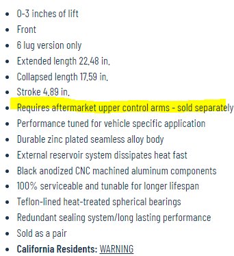

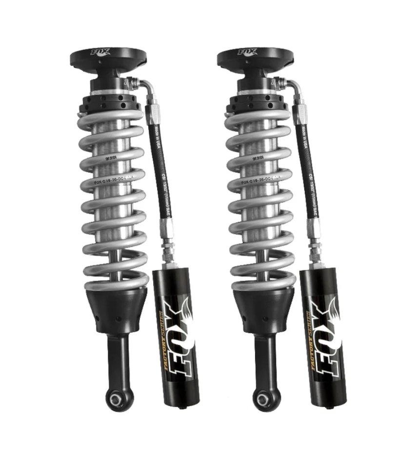

    Picked up a lightly used set of fox 2.5's. I now read new UCA's are required. I'm struggling to pick one. Was leaning towards SPC. I'm not a hard core wheeler and am targeting an inch lift with 265/70/17 tires. What would you suggest? (2020 Sport) Thanks!

    If you're only lifting one inch why would you need new ucas?

    It is just that Fox info I read said they were required.

    Are you 100% sure on the part number of the shocks? If not we can confirm that with a quick measurement on those coilovers for you.

    So do you think I can get away without new UCA's for now since I'm only targeting 1" lift (for now)?

    No. It's more about the droop travel you gain with the longer shocks, not about ride height
