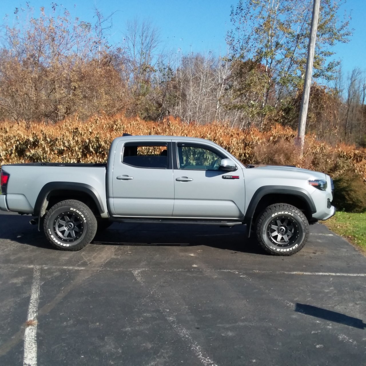

    my 2 cents, i put those shocks on my pro around 1 1/2 yrs ago, raised my front 2 in. never got it aligned, drives straight as can be, no tire wear, i did not need any adjustments, i was about 1 in. 5/8th threads showing
    my truck.

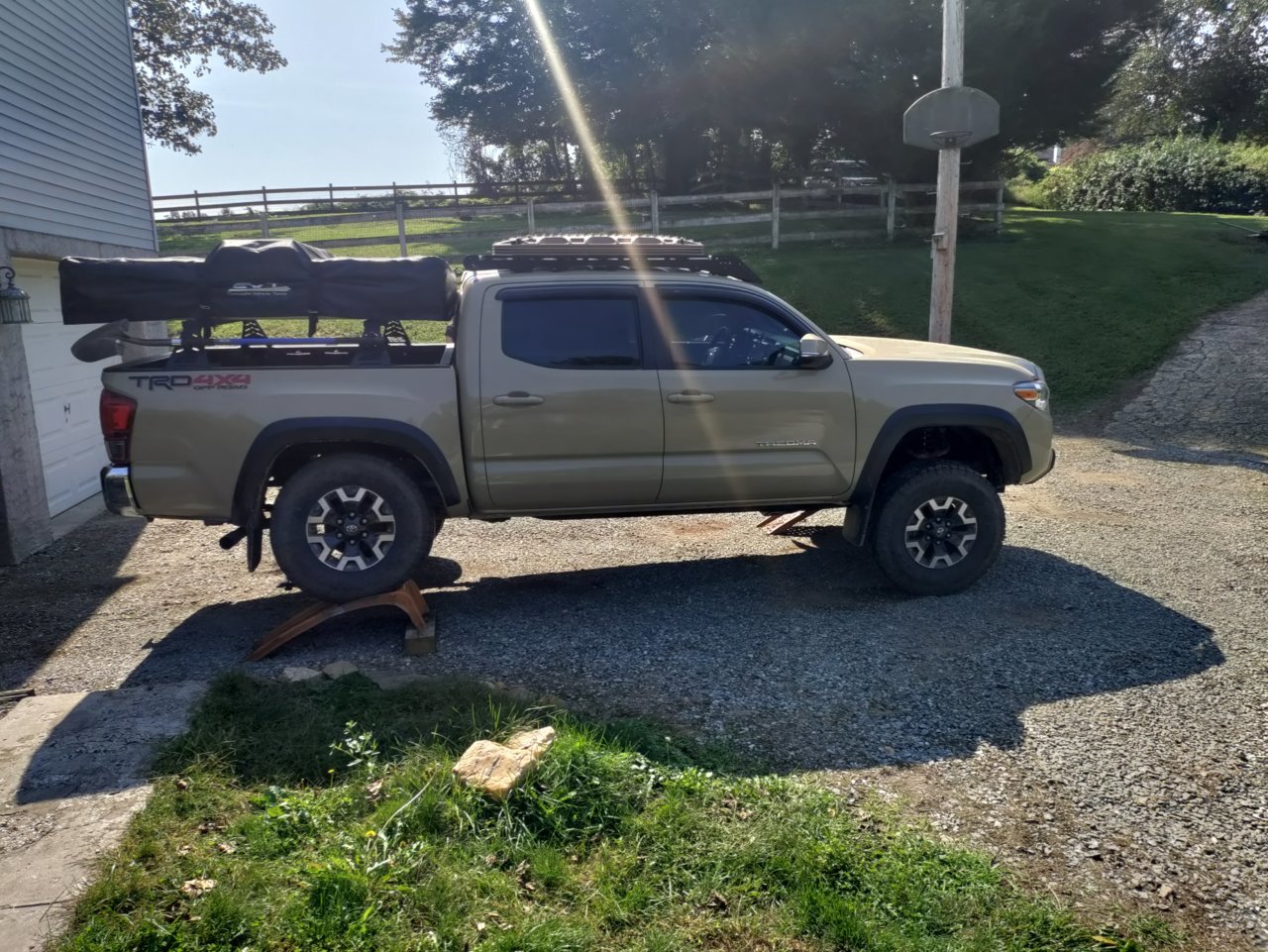

    I have had Light Racing (SPC) on my 2nd gen and JBA on my 3rd. I had considered SPC for my 3G but they had gotten much more expensive and the JBA design made more sense to me, and they are made in PA. JBA customer service was also very responsive to my questions. I would go JBA again in a heartbeat. I like that I can throw a GM truck ball joint in there just to get home.
    Like OP, I also did not lift very much. About 1" in the front and 3/4" in the back. I got UCA's and hammer hangers to maximize movement and obtain better alignment.
