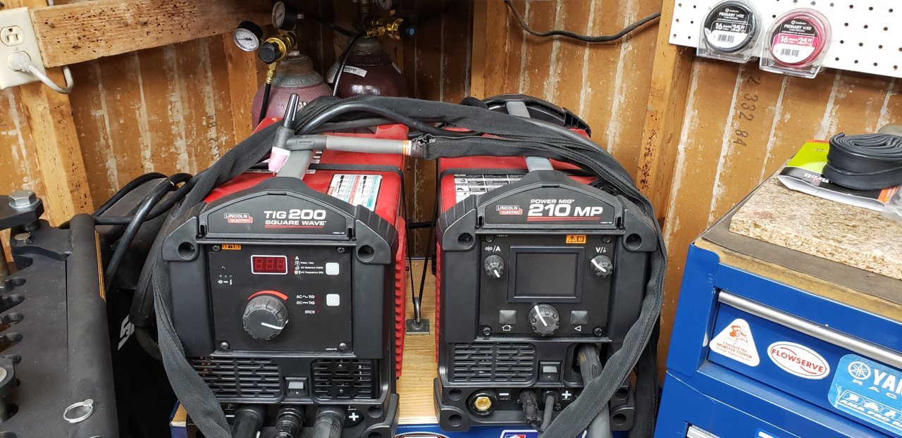

    Bigdaddy4760

    This is a great pair that will last you a long time. The mig had a sale of $999.00. Both are 110/220 and the tig also has ac. I have been a certified welder for 20+ years and my son is about to start learning on these machines.
