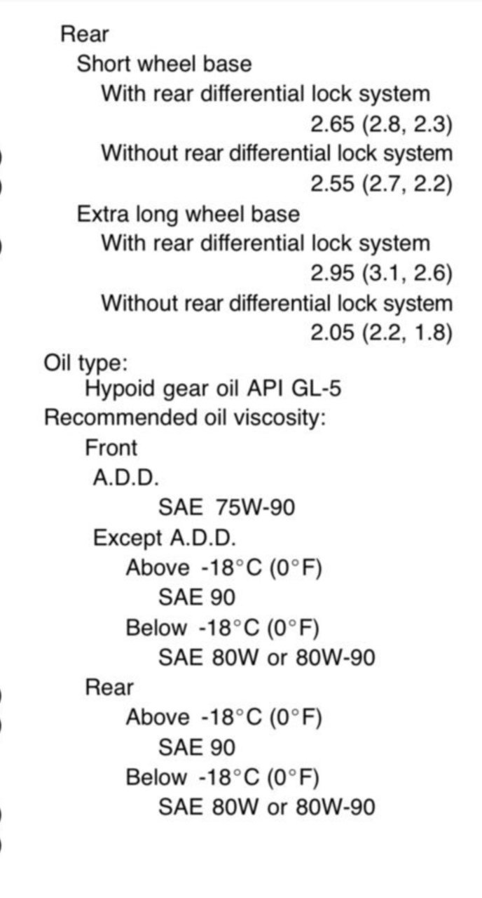

    Time to change out the rear axle gear lube. FSM says SAE 90 but what is everyone else doing? Dino, synthetic, additives and brands?

    Picked up 3 qts of Fram full synthetic 75-90 while I was out this afternoon mainly because thats what the local ADAP had on the shelf. Says it’s suitable for GL5 applications which I am guessing is the same as the SAE5 from the FSM.

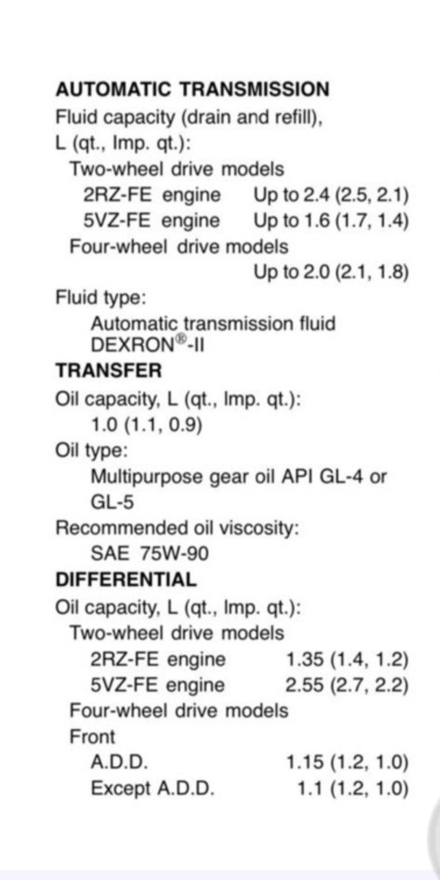

    About how much does it take. 99 Tacoma SR5 4x4 2.7L? I need to do front an rear

    Hahaha all sarcasm aside thanks for the detailed answer. Still learning this site the search function is kinda all over the place!

    I know someone that printed those and laminated them; keeps them in his truck which is smart.
    Was meaning to do the same but I just downloaded the pic.
    Don't even have a Tacoma or 4R anymore, but comes in handy for others.
    Recommend you save it for future use.

    Yes indeed I am definitely gonna screen grab it an print it for future reference and also how to grease the chassis which appears to have some straight PITA fittings that are gonna require an angled fitting on the gun
