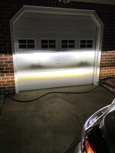

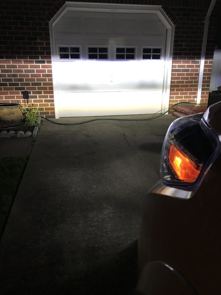

    Supernova v3 LEDs easy install, and wanted the GTR but didn't like the hassle to install.
    This is 20-25 ft away this is with rigid fog lights off a TRD pro.
    10-15ft away

    How much scatter are you getting? From what I have read, the housing doesn't support LEDs well and emits light worse than the stock halogens at farther distances (20-50 feet).

    The SuperNova V3s appears to have the exact same throw as stock lights. Very happy with them so far. Watch the video I posted above. Some LEDs do emit worse than stock, particularly the OPT7 that everyone on here recommends.

    I agree with this. Definitely worth the pick up IMO.
