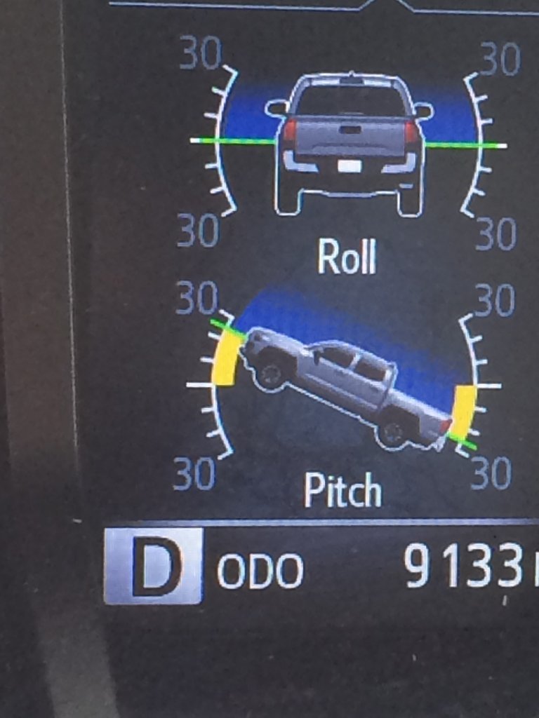

    I've got taller E load tires, and keep 'em at 32psi. In the summer I see them climb as high as 37 psi in extreme hot days, and goes back down to 32 psi on their own. In the winter they sometimes drop to 29-30 psi, but again climb back up on their own. This is all viewed from my go-to screen settings.
    Quick switch on my steering wheel buttons, and I'm on this screen in a flash.
