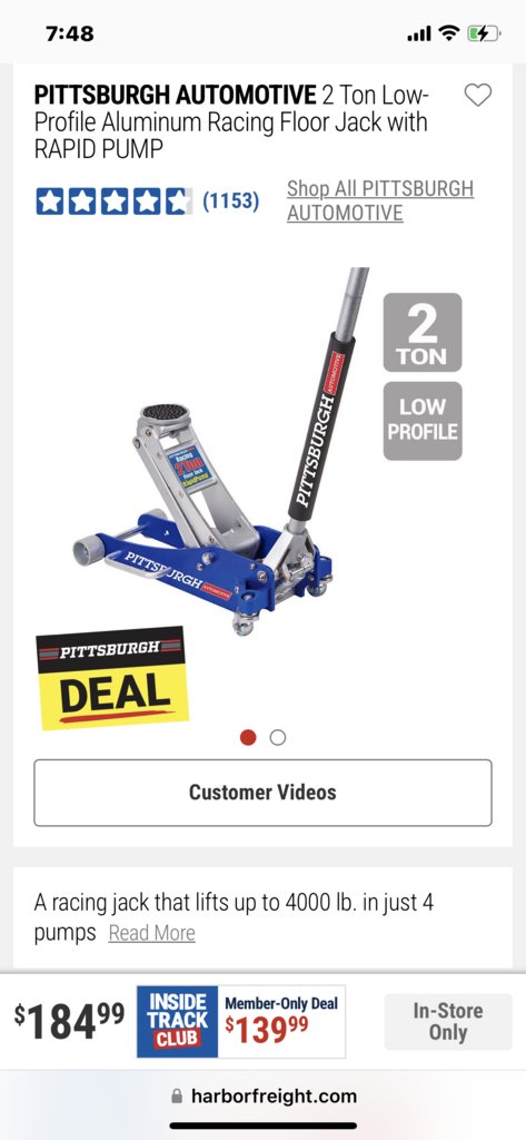

    Wondering what is the minimum floor Jack rating needed to safely lift stock height 3rd Gen. Also does anyone know of a compact safety rated floor Jack that can fit in the rear left side floor of access cab 3rd Gen? Would aluminum Harbour freight floor Jack 2 ton be enough given weighing less?

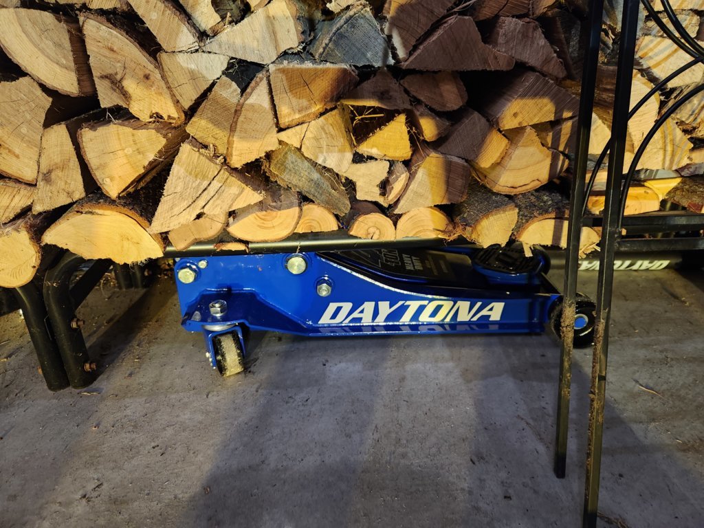

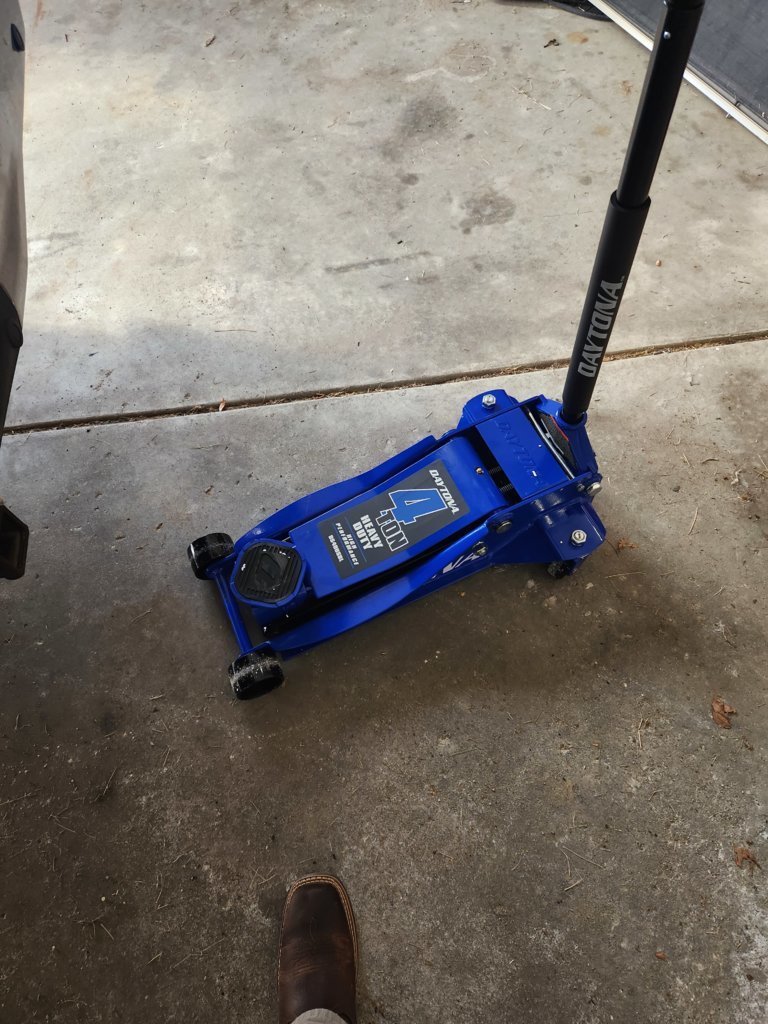

    I believe it should support ¾ of what the vehicle weighs. I'd pick up at least a 3 ton. Funny I saw this pic. I just picked up a 4 ton jack this morning to do my brakes. Really happy with it and it stores perfectly under the firewood stack in the garage! :)

    I wouldn't hesitate to use and carry their 2 ton aluminum jack. I've done exactly that for many years.

    At home I use a daytona heavy duty 3 ton jack, and I do lift kits on Toyota trucks almost every week. For camping trips I bring a 1.5 ton aluminum jack. It's under powered but ok to lift 1 corner off the ground. Definitely incorporate a jack stand or something else to help support the vehicle when using any jack, but especially a small jack.

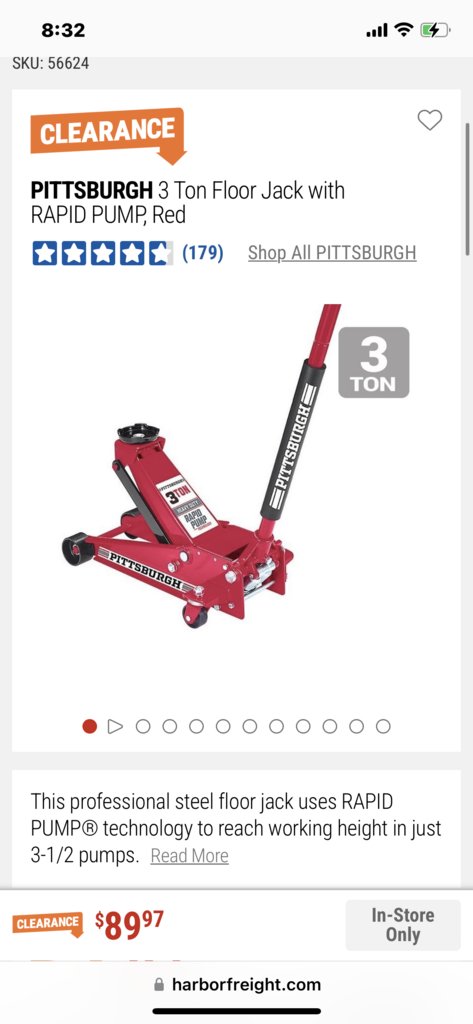

    Just saw they do have this one for a good price. For the listed 3 ton as recommended minimum. Probably would just put it in a tote or pelican case in the bed since won’t fit in rear access utility floor area.
