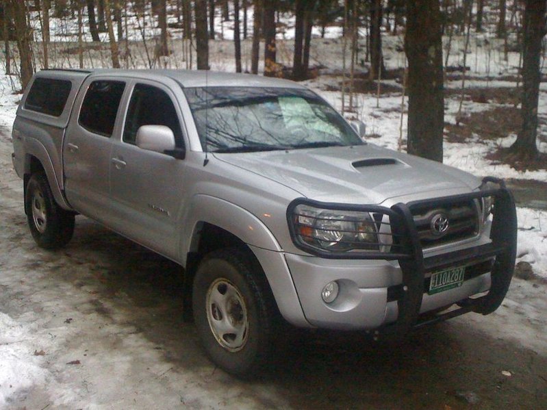

    I'm running 265/70/16 winters (on older steel tacoma rims) and have no problems with rubbing although I'm really not 4 wheeling in my new truck. Still on rough roads though. Take a look.
    I agree the stock tires look weak. I want to get Goodyear Wrangler 265/70/17 's for my 17in sport rims. Also want to paint them black but don't have the balls to paint brand new rims! I'll Paint the Steelies when I take them off.
