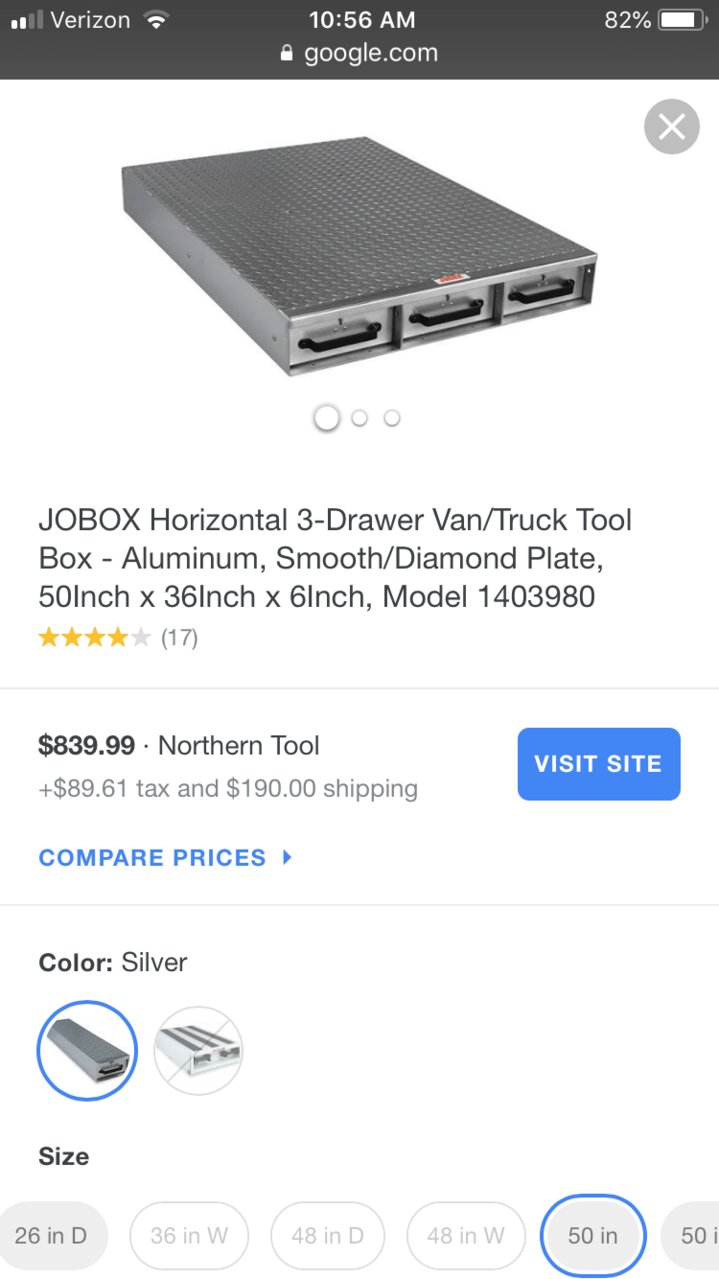

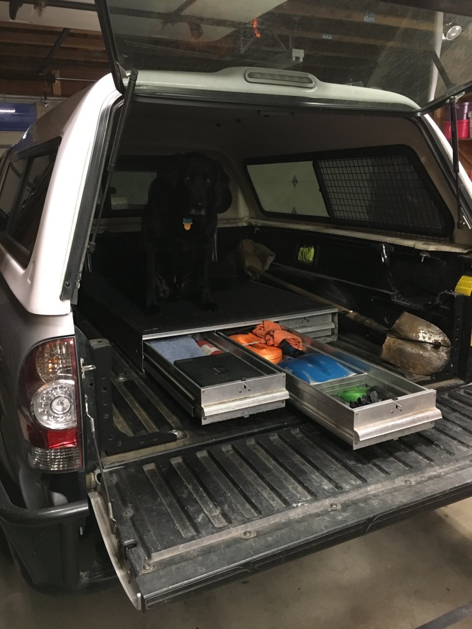

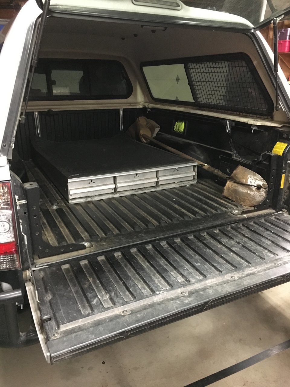

    I have the Jobox 1403980, it has three drawers that are 48” long, 12” wide and 6” high. It fits great in the full length Tacoma bed and still leaves a lot of bed space. I’ve found two on Craigslist, for $250, brand new they run about $1000. It could hold most rifles/ammo and be locked up. Took me a long time time find one, but I love the fit in the bed. I’ll add some pics of how mines mounted when I get to my truck laterA889DE19-D097-4C56-B4A0-08D81AC9F1FD.jpg

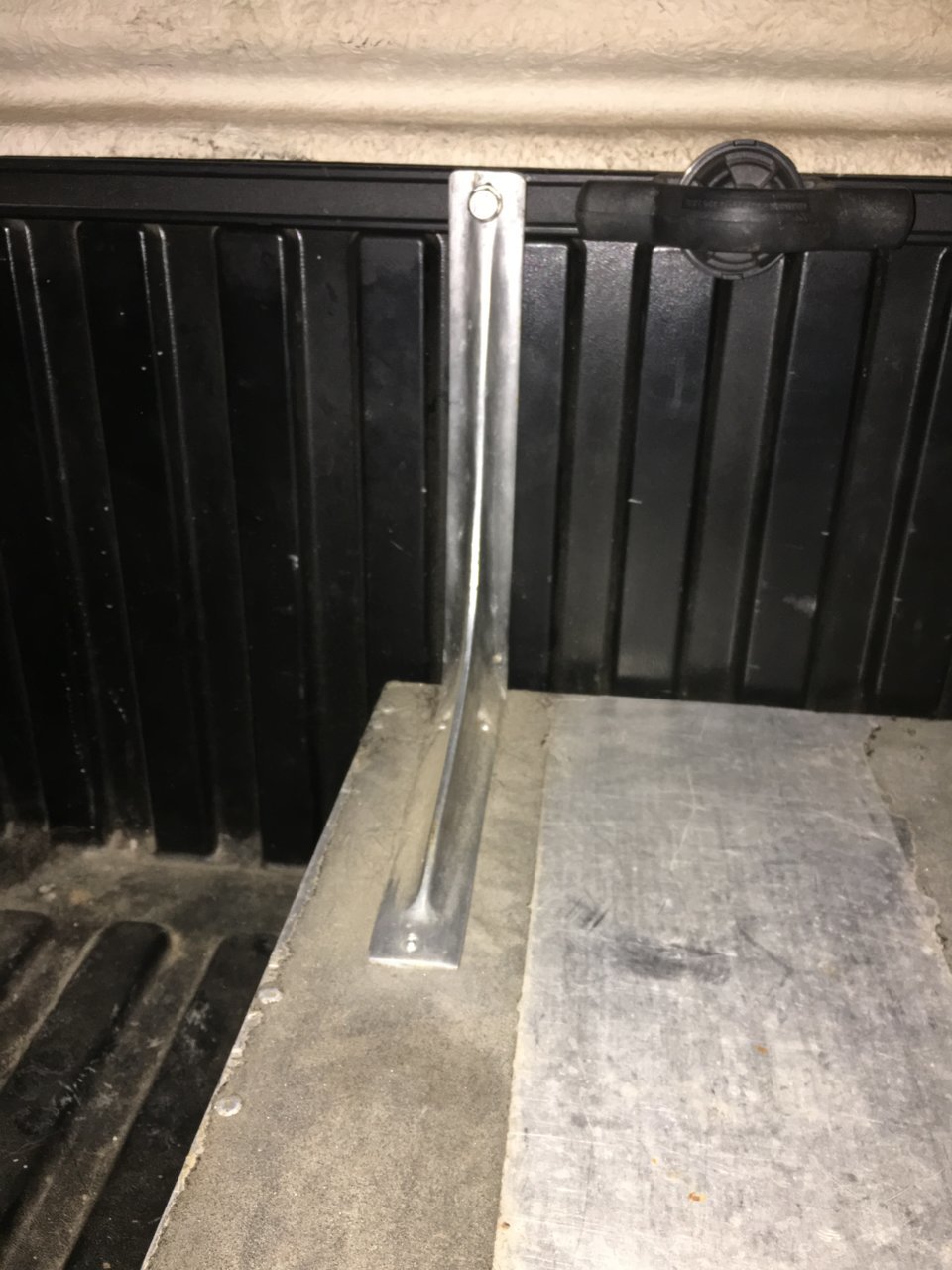

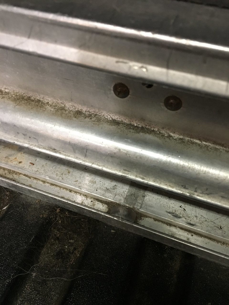

    Here are some pics, the back is secured with some brackets bolted to the bedrail with t-slot nuts, the front (tailgate end) is bolted through the bed with carriage bolts ground down to fit in the channel89CF3B27-4906-48FD-B516-89F3C38928A3.jpg68B8931B-EB68-4735-BBBA-4336F7AB21E4.jpg 1A42677D-3757-4C37-B7CB-069F2895964C.jpg92C4C93C-51E4-4560-87F7-7B6CC0FADAAB.jpg

    Sweet setup man. I wish craigslist was good in my area I'd buy that lol.

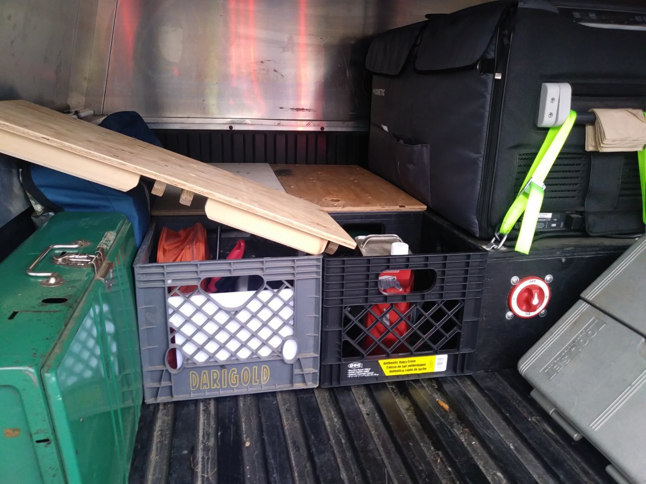

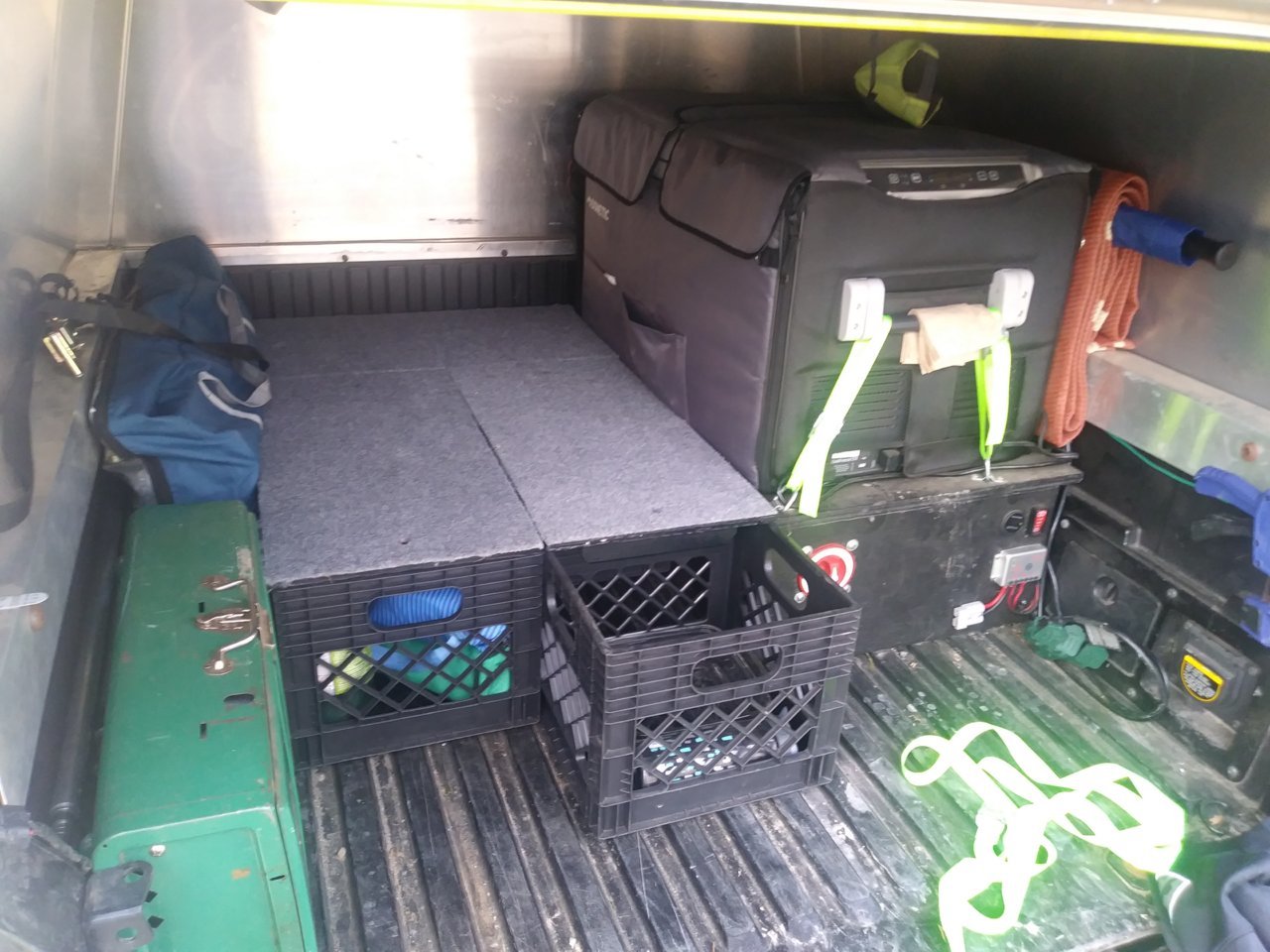

    My super cheap bed storage system! 6 milk crates! Could fit three wide easily if not for the battery/fridge box. Obviously not for everyone, but we love it.
