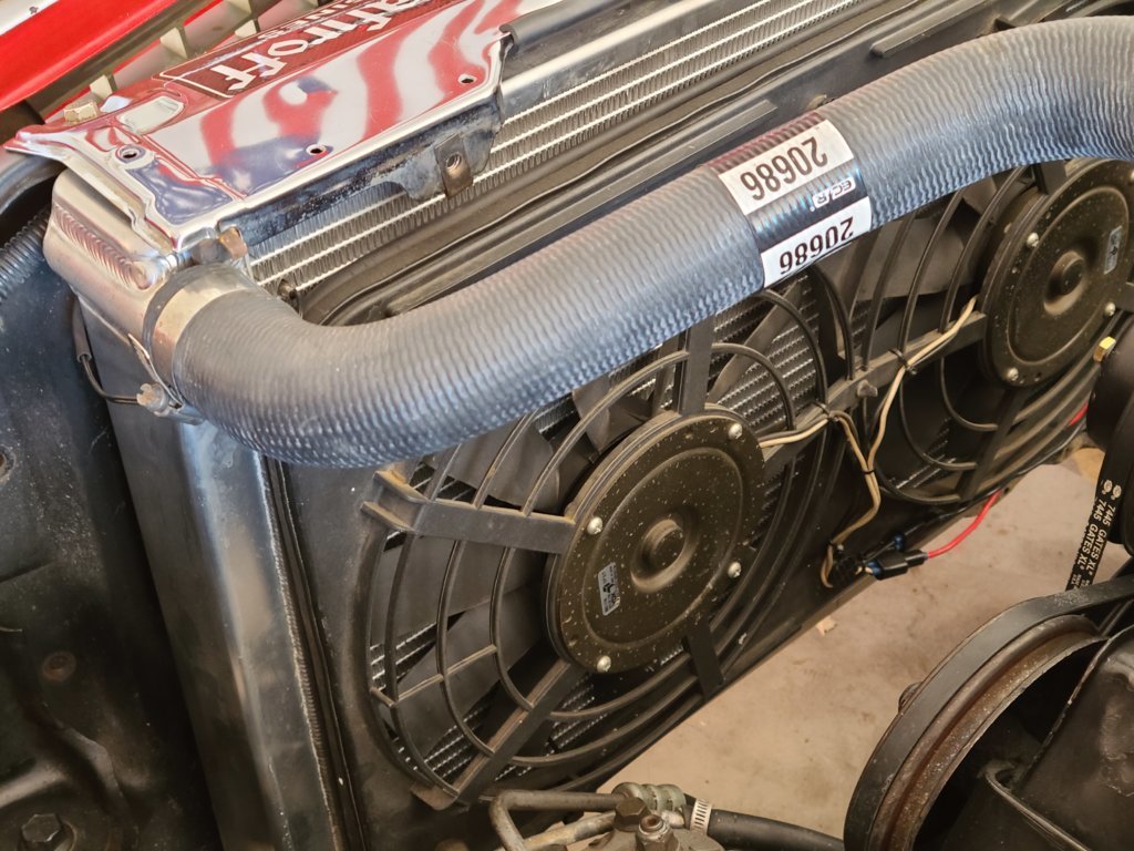

    I'm running a Flexalite #680 dual fan with dual 12" dia 2500cfm fans designed for a first gen Toyota truck . I'm running this fan set up on my 1972 Camaro SS that has a 600hp Shafiroff racing engines 427sbc . This fan keeps engine temps at 180° even during hot and humid summer days in Middle Tennessee
