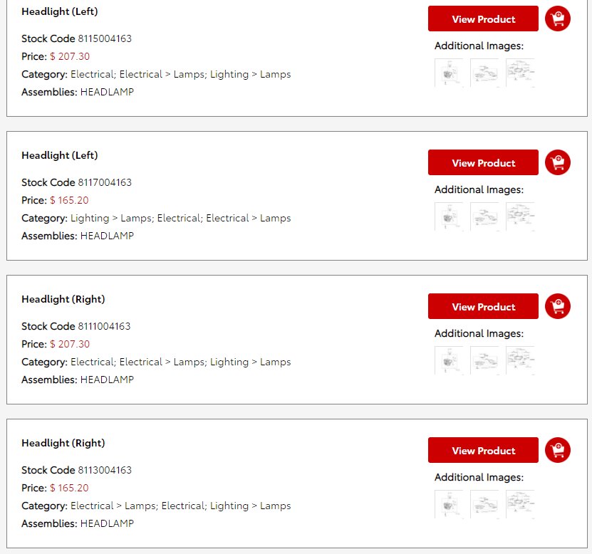

    Can anyone help out with these part #'s. The site shows these for my VIN. What's the difference?

    I don't understand any of those... the fact that it shows that it fits 2005-2012 can't be correct. The ones I ordered for my 2011 show they fit 2005 - 2011. 2012 was when they got the facelift.

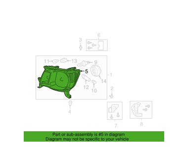

    OK, that website just sucks. The part numbers are correct, but the cheaper ones are the headlight assembly only, doesn't come with any of the stuff with the little dotted lines below, only the housing.
    Found this image to help explain. Cheaper comes with green highlighted only. Not the other bits.

    So I can safely order the $207 ones for my 2011? I'd like to pull the trigger before the free shipping disappears. Thanks for the help.

    YES

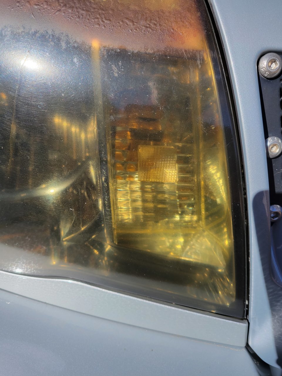

    When I purchased my truck the headlights had been smoked with some kind of aftermarket paint and LED bulbs put in them. Eventually the smoke coating on the lights started deteriorating and proved to be almost impossible to remove from the lenses.
    I decided to start looking at replacement lights and found virtually nobody was happy with any of the aftermarket lights. I was shocked at the price of the OEM lights at the first couple of dealers I priced and decided to dig deeper. I even looked at ebay but all the used OEM ones I found on there were in really bad shape.
    Considering what some dealers want for those lights and the $233 price tag per side I found, I felt pretty good spending the extra $250 over the price of the after market lights to get OEM lights and not have to worry about them again for another 10-15 years.
    In addition I did order some 3M clear car vinyl wrap I am going to apply to cover and protect my new lights though so I don't expect to have hazing and yellowing for many years.
    this is what my current lights look like:

    Note that vinyl wrap does reduce output somewhat. But also important is that the wrap will also eventually yellow and haze. You might consider it sacrificial to save the headlights but often the films are not removed without effectively damaging the headlights. So you put a film on them which reduces performance to protect them, but in the end may not actually achieve that goal when the film starts to fail and needs to be removed. OEM headlights will have much better UV protection than aftermarket. If really concerned about UV breakdown, personally I’d look at the maintenance style coatings that you apply ~annually like a wax. Does not harm the lights, eventually wears off and does not noticeably reduce output intensity like a film and will extend lamp life in high UV environments.

    Interesting point. I have read that the tinted wrap reduced light output but not that the clear did. Are you referring to the clear wrap when you say it reduces output? On another note the 3M brand is rated for a 5-7 year life span before which time I would plan to remove and replace it. I know if the film is removed in a timely manner then it is not difficult to get off with a heat gun or hair dryer. But if you wait too long then it can become difficult.
