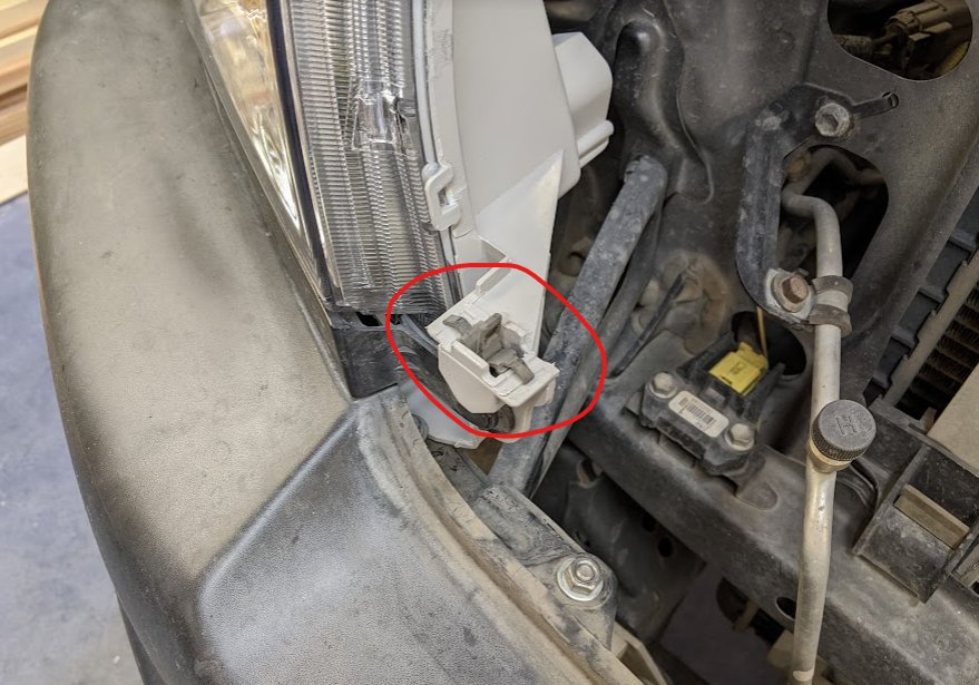

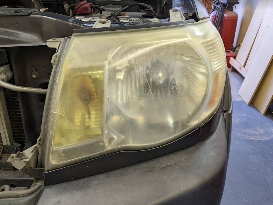

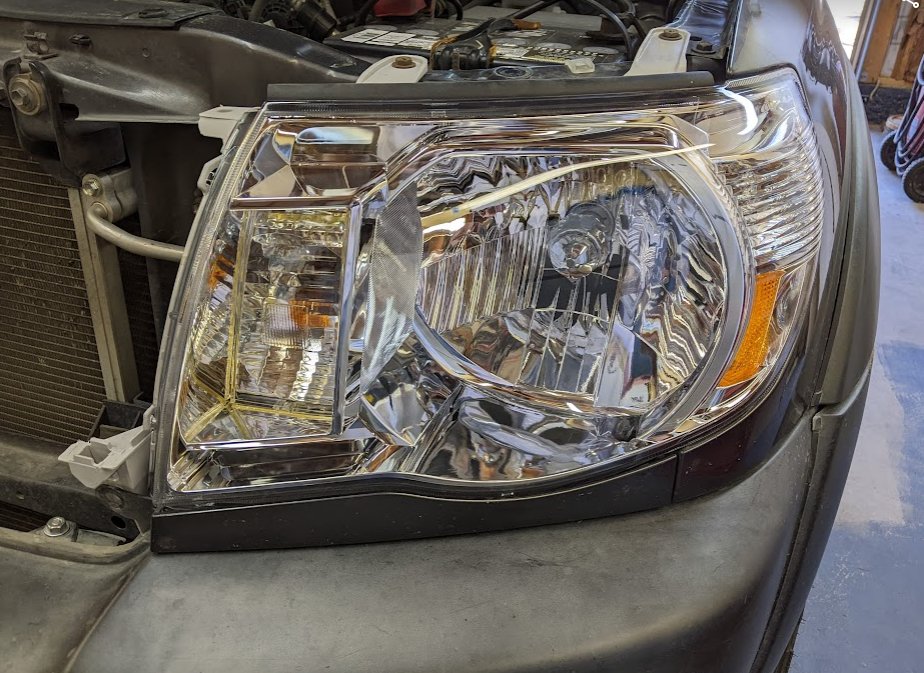

    Did the install today. Not too bad at all. The YT videos made a big thing about the lower/hidden bolt, but I was able to reach up from underneath without much trouble. I've dealt with much more challenging to reach things.
    Before:
    After:

    Anyway, I'm not too stressed about cosmetic stuff generally, but this makes a huge difference. Probably brighter light too.

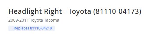

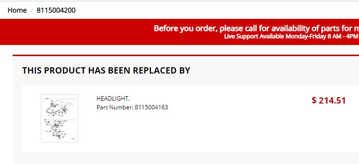

    Looking at a couple different websites, I think your replacement parts have actually been replaced with what you have as the "Old part".
    Here is one example, with 81110-04173 replacing 81110-04210
    On this one 8115004200 has been replaced by 8115004163

    not hard to change except the 0ne bottom bolt.

    Some time ago I read in another thread on headlight replacement that that PITA bottom bolt really didn't need to be replaced when installing a new housing. Not sure if true, but a few people stated they left it off with no issues.
