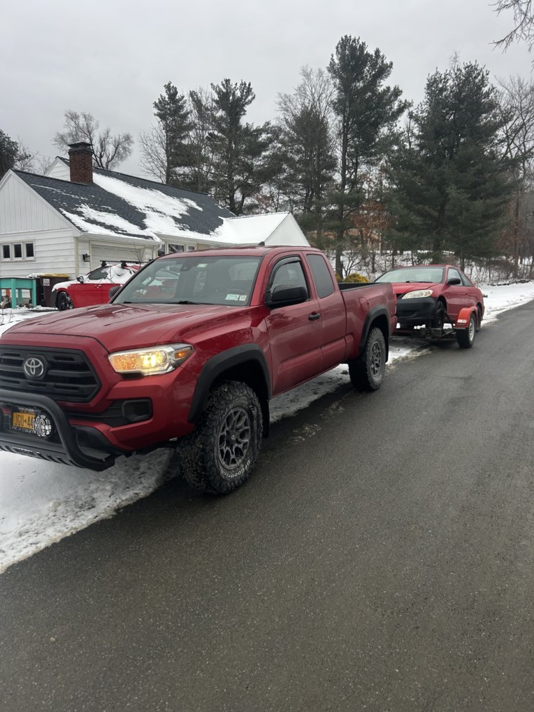

    Meh, uhaul car dolly works fine. I towed my 04 s60 4 hours on one and it worked fine. Turn on ECT power, leave it in s4 and just drive. Got about 10mpg.
