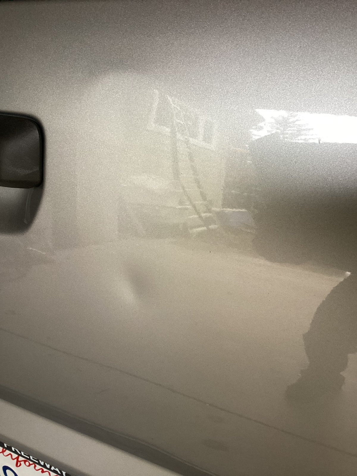

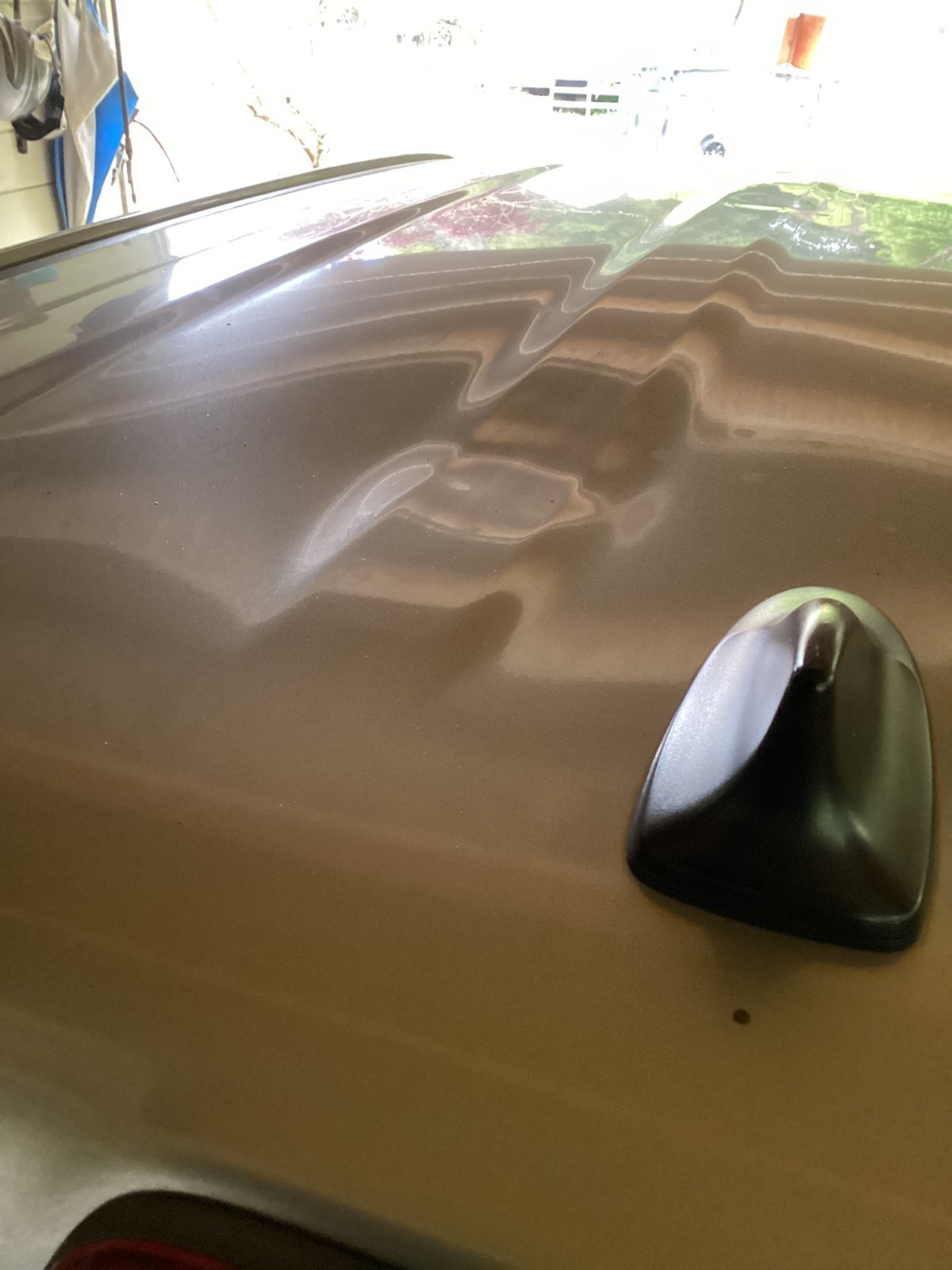

    I have a couple dents on my 2015 Tacoma and was wondering which repair kit you guys have had success with. One dent is on the tailgate and is about 1-2” wide and the other is on the roof and is about 4-6” wide. I’ve done some research but some of these repair kits only handle metal up to certain strength and can pull dents certain sizes. The metal on the roof seems thin compared to the tailgate. Attached are pics of the dents.

    Is pricing usually reasonable to hire a pro for this type of work? Risky doing it myself?

    you could try pulling the headliner and push it out with your hands and hope that doesn’t make it worse.

    Kinda depends. Pricing will vary wildly on PDR - but so will quality. Try to use someone who has really good referrals from others. Don't expect it to be cheap. The $100 quoted in the other post is crazy cheap as far as I'm concerned. That's cheaper than the hookup price I got via a friend who hooked me up with the guy that does PDR at his dealership. Of course it could be apples to oranges in terms of our two different dents.
    Also, they don't always need to remove interior panels. They can often do a lot from just the exterior. The one I had done recently was a small, but DEEP ding (including minor paint chip) on the rear quarter panel of my wife's CR-V and he pulled out 100% of the dent without removing any interior panels. But I definitely agree you might be able to save money / make their job easier by removing panels if necessary - just ask them in advance in case it isn't actually helpful.
    I can pretty much guarantee that you won't do a perfect job if you do this yourself. So feel free to try it DIY if you just want to learn the skill or don't care what the truck looks like when you're done. PDR isn't something you can easily DIY, it's something that takes a lot of skill and practice. But, bigger, softer, dents (kinda like what it looks like is on your roof) are definitely easier. That one looks like it might not look too bad just "popped" out. The one on your tailgate is smaller/deeper so you'll probably pull up the area around the dent while trying to pop it out, then you need to massage that back to being straight. Don't believe the miracle product informercials you see.

    100%. That dent on your roof spans the raised roof rail bodyline. Those are notoriously more tricky. Had a local PDR pro (old timer) do the same when the truck was new to me; truly is an art like @Too Stroked said.
