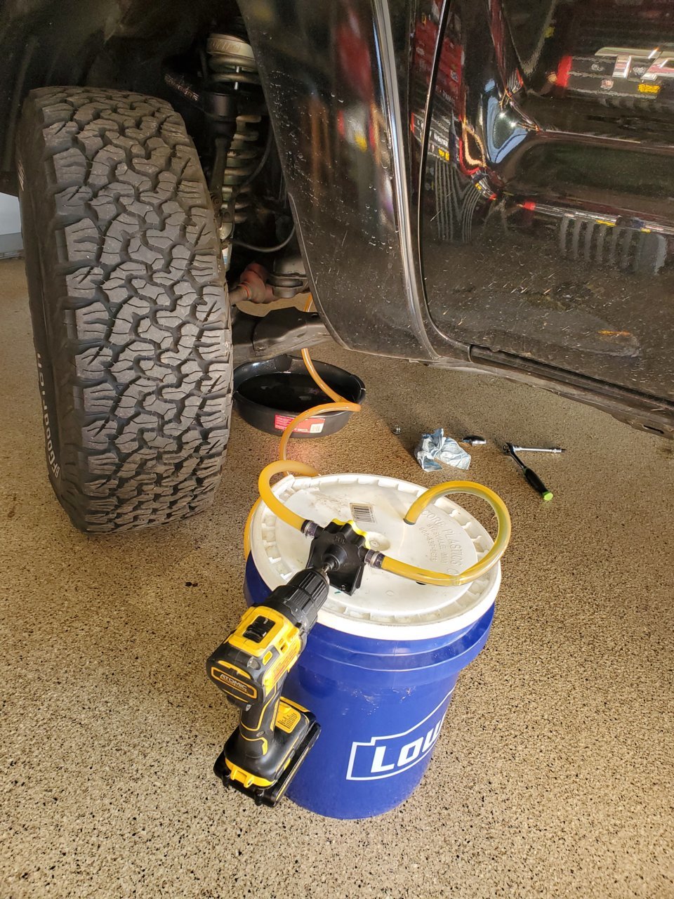

    20211219_143508.jpgEnded up buying the fluid pump, hose and a bucket. Works great and made it a really simple task. I was refilling the diffs and tcase with 85w140, which is super thick like honey. I suggest warming up the gear oil beforehand, it pumps in so much faster (it was 32deg F here today). It also helps to prefill the intake hose as the priming will go quicker, plus the pump says not to run it dry. The pump shows a directional arrow, but when i was done i ran it backward slowly to empty the hose back in the bottle...clean up was a breeze.
