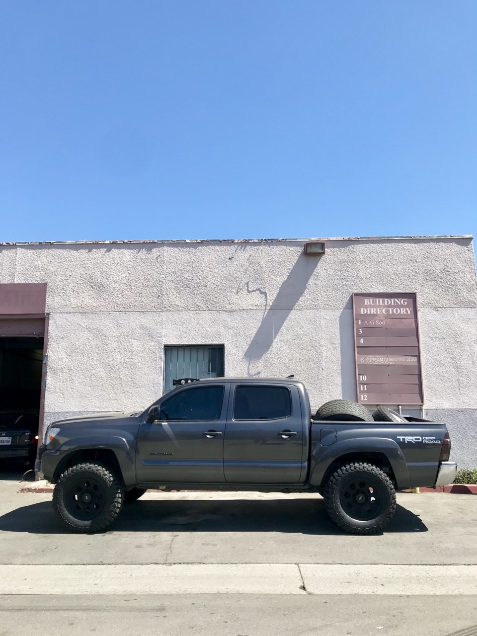

    Thanks I’m honestly considering the Aal ! Hmm I know forusre i will have some rub I got a call from my tire shop today saying that they have my tires ready and are waiting for my wheels to come in now. Wheels are 17s just hoping I won’t have to do much trimming..

    I think the offset is -19 I just got my new tires mounted today!

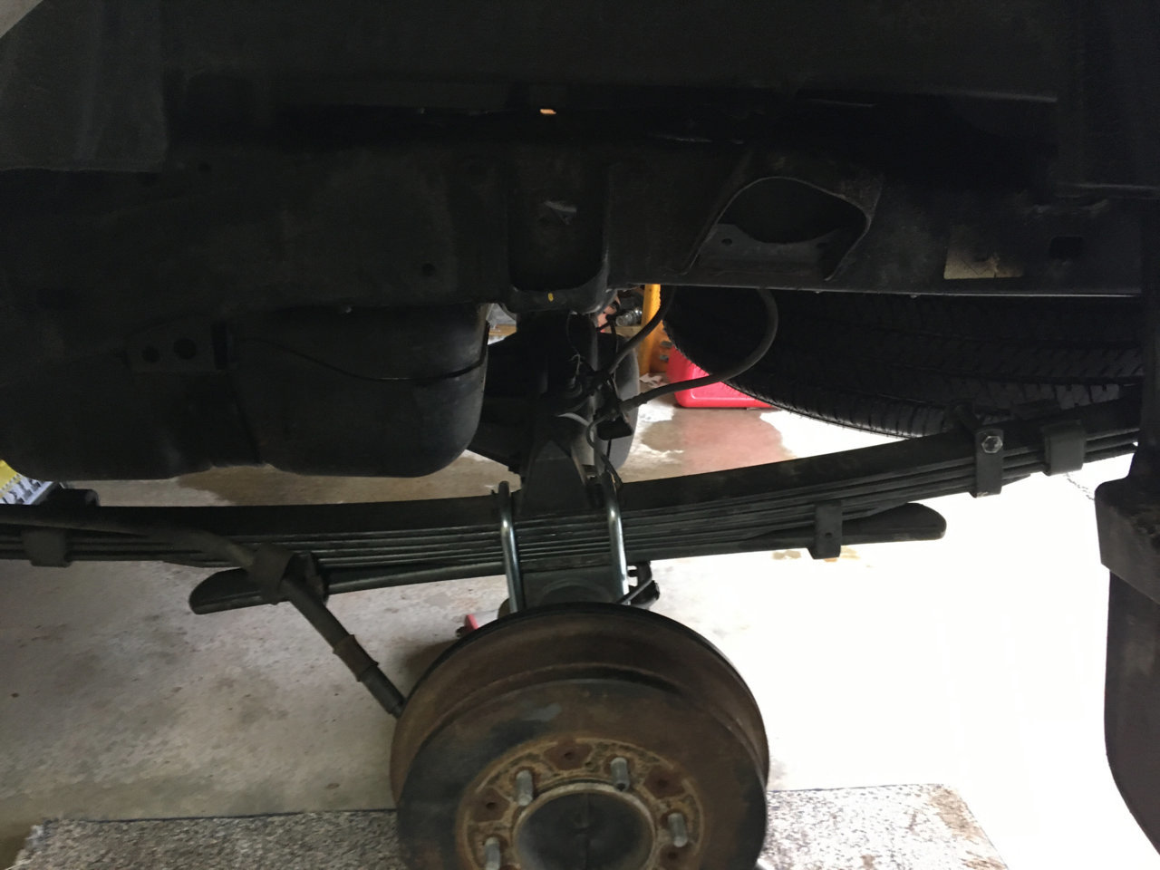

    This is what I did. Icon aal with ol leaf in. 2” lift exactly from stock.
