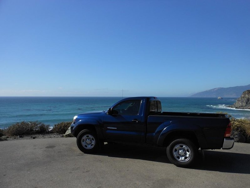

    Well, I just put on a set of Bridgestone Alenza HL Duelers (stock 245/) & at just over 36,000 miles my shocks are toast. I'm ready to buy & am still interested in the nose lift to make it level.
    Being that I asked this a few years ago, have there been any other shocks or leveling kits that might be more of an improvement than than these, or are they still the hot ticket for what I'm trying to achieve?
    I'm hesitant about an AAL because I don't want to make the ride stiffer in the back. Does an AAL make that much of a difference in stiffness with an empty bed? The heaviest thing that I would haul is my sport bike & that won't be too often. We'll see how it does once I finally get front D-rings put on the front bed bolts.
    I want to kinda filter down anyones photos. If anyone has any photos of Reg Cab Pre-Runners running stock size (245) tires & 5100s installed to level please post them.
