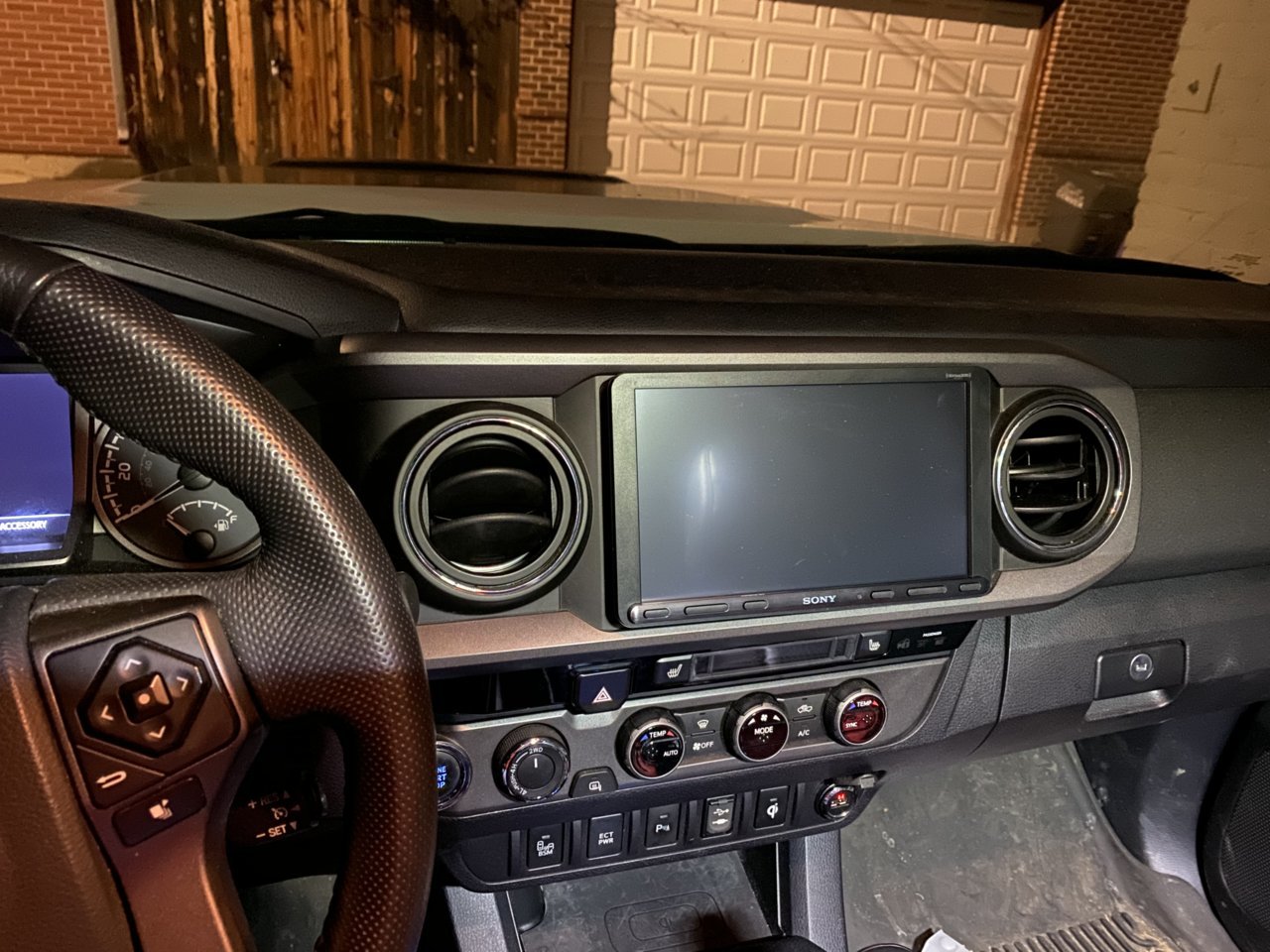

    Just did a test fit for the Sony AX8000 now... should work great. Going to get it mounted and installed tomorrow. Will require some custom work to make work properly and securely if I want it flush to the dash.. Will try to document it once done.

    lol, well- all my favorite car audio memories are from the late 90's and early 2000's... I still have a Sony CDX-C910 sitting around here somewhere. I actually really like the final fit- its flush against the dash... unlike the alpine halo9 which sticks way out there.
    ill post some better pictures tomorrow.

    Please let us know if the steering controls and back up camera work properly with this unit. Thank you.

    All works well. I had an idatalink maestro RR in the vehicle from my Alpine ILX-107, flashed it to the Sony AX5000 (8000 isn't an option yet on the Maestro site) and all seems to work.
