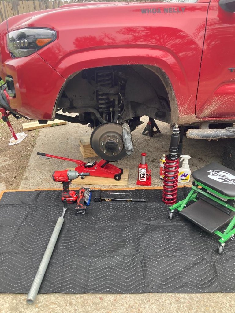

  8. May 22, 2025 at 11:22 PM
    Diver_De_Taco
    Diver_De_Taco Active Member
    Jun 12, 2024
    #451381
    44
    ‘23 TRD OR
    If your stock coils are still in good shape, just get the shocks, get an AAL for the rear. That’s what I did, night and day difference compared to my stock suspension.
