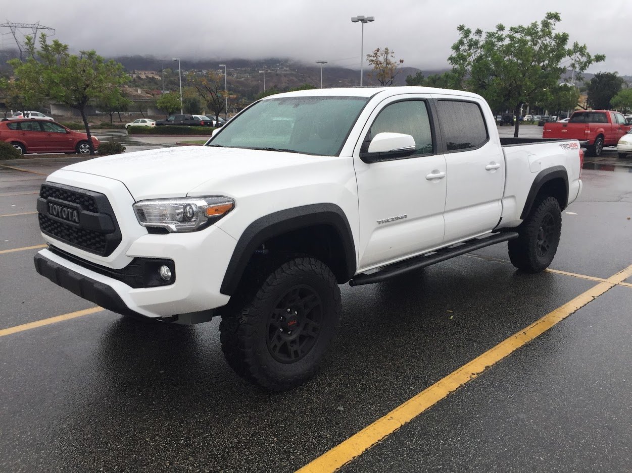

    I went with the simple AAL from 4-Wheel Parts (https://www.4wheelparts.com/) and got the lift and ride I like. I carry a dirt bike a lot in mine and it's a non-issue.
