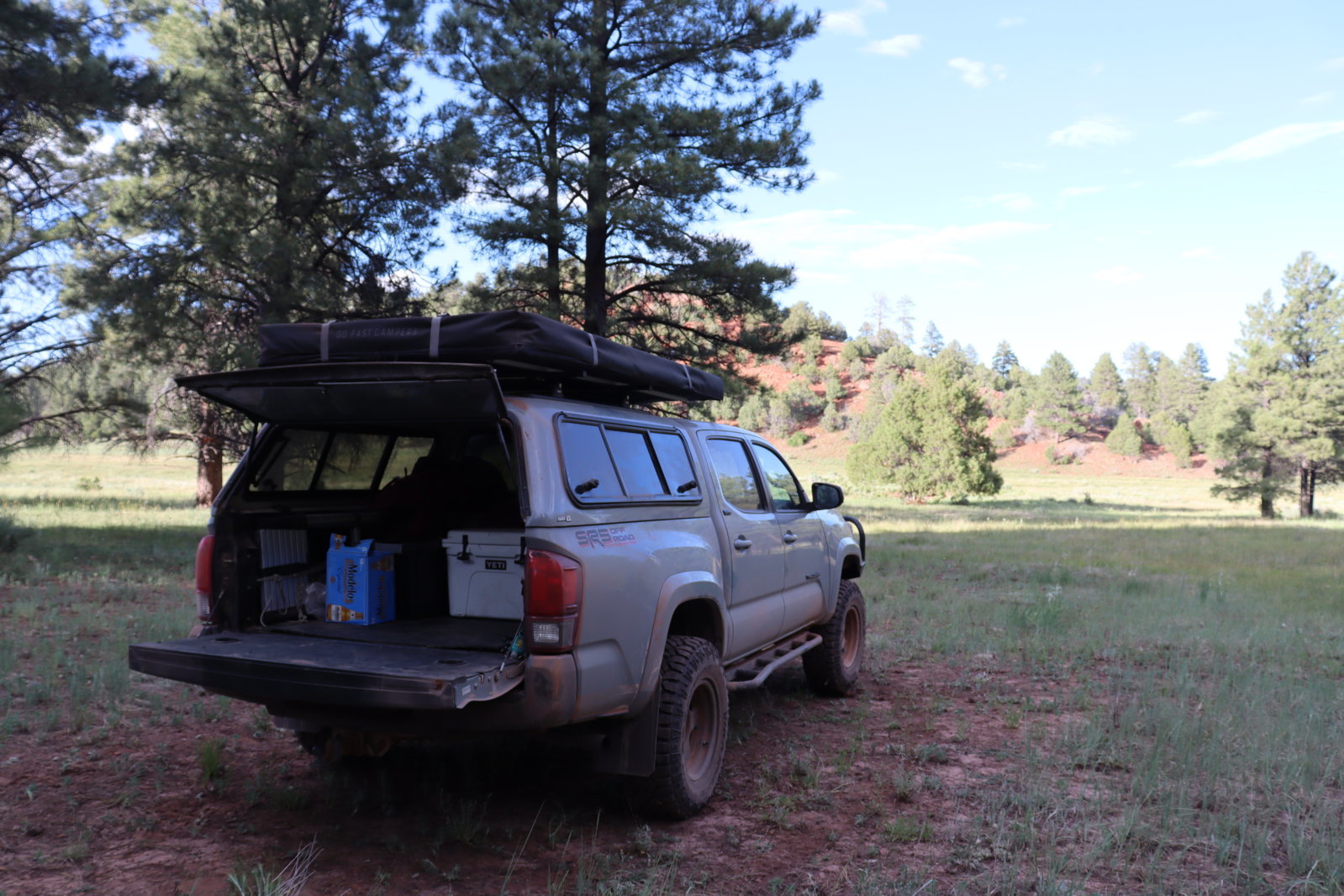

    3rd gen tacoma here. With my bed rack, awning, gear, and rooftop tent I'm carrying somewhere near 300+ lbs. I'm noticing some significant sag/squat in the rear as well. In my rears I have the stock leaf springs, ICON 1.5" rear reservoir shocks, and the ICON 1.5" AAL.
    I had three questions; what were the stock 3rd gen Tacoma leaf pack original weight capacity, do I need to get new shocks to support the new leaf pack, and what leaf pack do you guys recommend I should get? I've heard of Deavers and Dobinsons.
