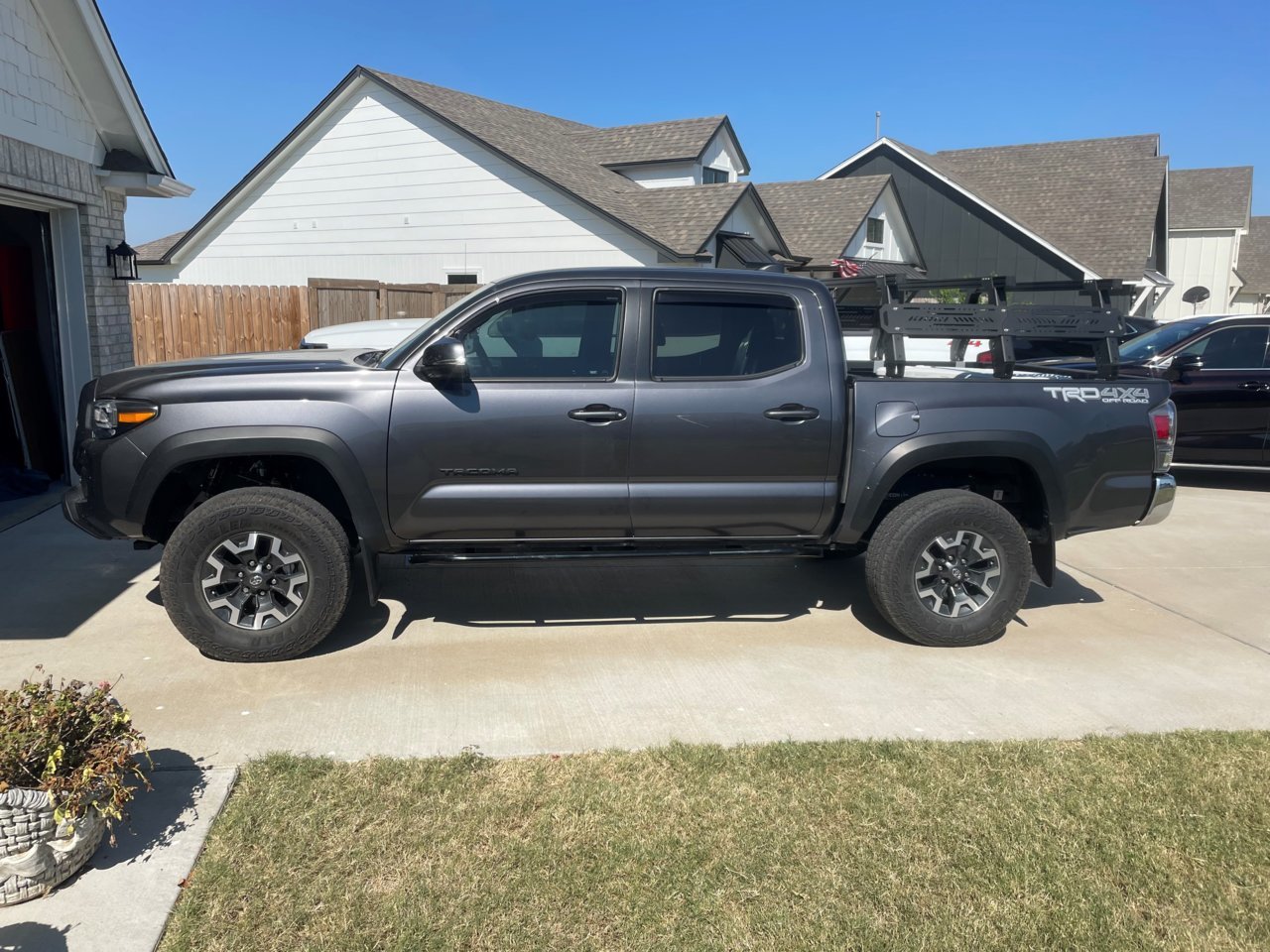

    Installed Icon Stage 4 on 2022 TRD Offroad. Added 2" of lift. Only been on pavement so far but ride is so much better than stock.

    looks good and level, what leaf option are you running?

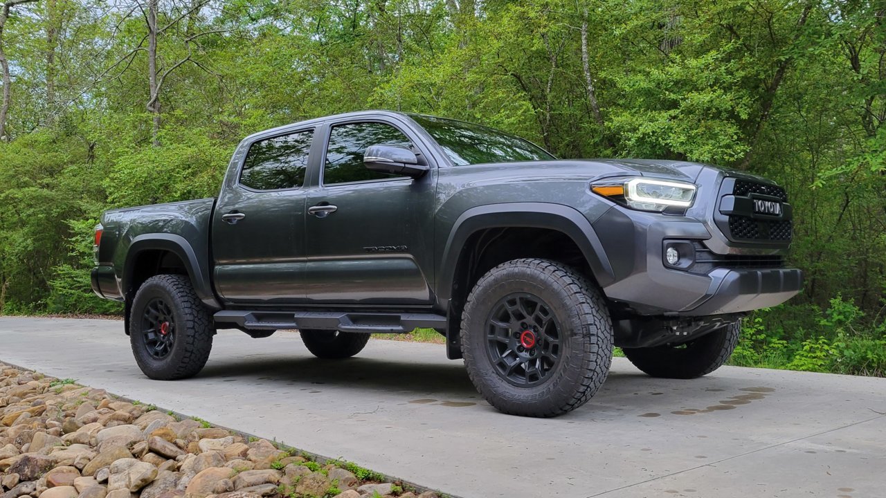

    A minimal but good quality set up is Bilstein 5100 with a progressive AAL in the rear. This set up will add up to 2" in front and 1.5" in rear. A 1" block in rear instead of the 3AAL will save you a few bucks but the AAL will help your factory leafs last longer and increase your paylod a little. 5100 were a significant improvement over the TRD OR Bilsteins on my '23 Taco. Here's a pic of my 5100 setup at 1.55" with 265/70r17's.
    Do more research before you lift. There's a lot to consider. I would not do a lift without also doing the ECGS bushing on the drivers side axle.
    Do you do your own wrenching? There's tons or good vids out there. Do you already know of a shop for the work? Are they familiar with the ECGS bushing?
