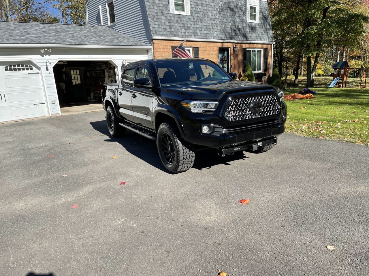

    And I already have a nice set of wheels and tires, RBP Spike in Gloss black 18X9 with Nitto Ridge Grappler 285X60.
