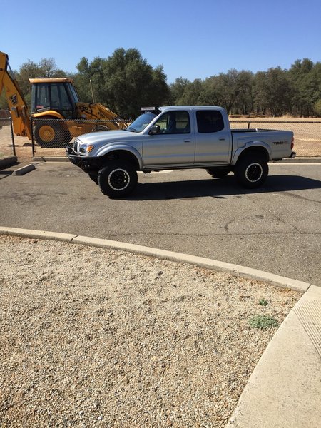

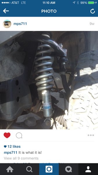

    I ordered Bilstein adjustable 5100's in the front w/ Eibach 3" coils and Camburg UCA's with regular 5100's in the rear and a 1.5" AAL. Here is what the front suspension looks like and here is how my truck sits.
    ChadsPride likes this.

    My Tacoma is an 04. And I bought everything from ToyTec.com except the Camburg UCA's that I got from Downsouthmotorsports
