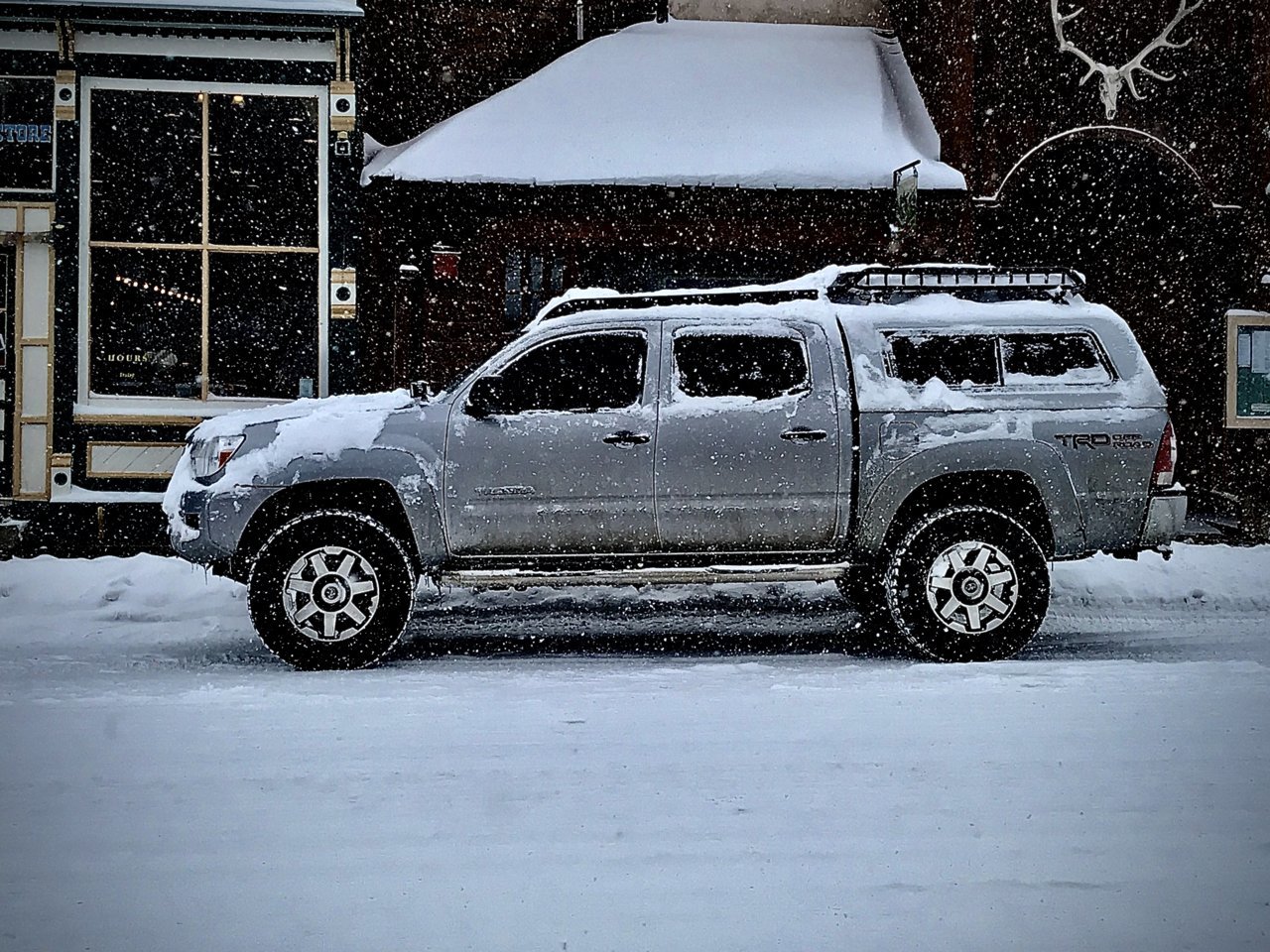

    RCI 12" HD Bed Rack with Tonneau Adapters RCI Bed Rack Awning Adapter OVS TMBK 3 Tent CVT Pioneer Awning with Annex 265/75r16 BFGoodrich KO3
    I have to go with this as well. I struggled for a while and decided to go this route. Super helpful.
    OME 887, 5100s, ICON 3 leaf AAL. The thumbnail pic is right after the lift. Couldnt be happier.
