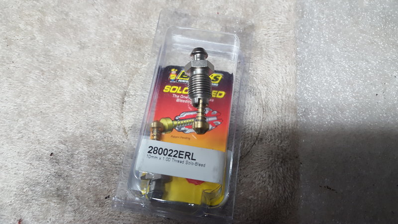

    Brake bleeding upgrade.
    Biscuits likes this.
  11. Dec 6, 2016 at 10:07 AM
    #31
    Biscuits
    Biscuits Thorny Crown of Entropy
    Aug 8, 2010
    #41397
    15,577
    Swiggity swangin' biggity bangin'
    Those things are tits. Have speedbleeders on my 600RR but haven't yet installed them on either of my Tacomas. Stupid me.

    :thumbsup:
    After using one for the clutch line, I am completely a believer in their value. Much easier to bleed without cavitating the system and causing tiny bubbles. Slow pedal modulation makes it precise and very timely.
    Biscuits[QUOTED] likes this.

    how much were these, where did u get them

    Summit Racing. About $17 + shipping. :thumbsup:
