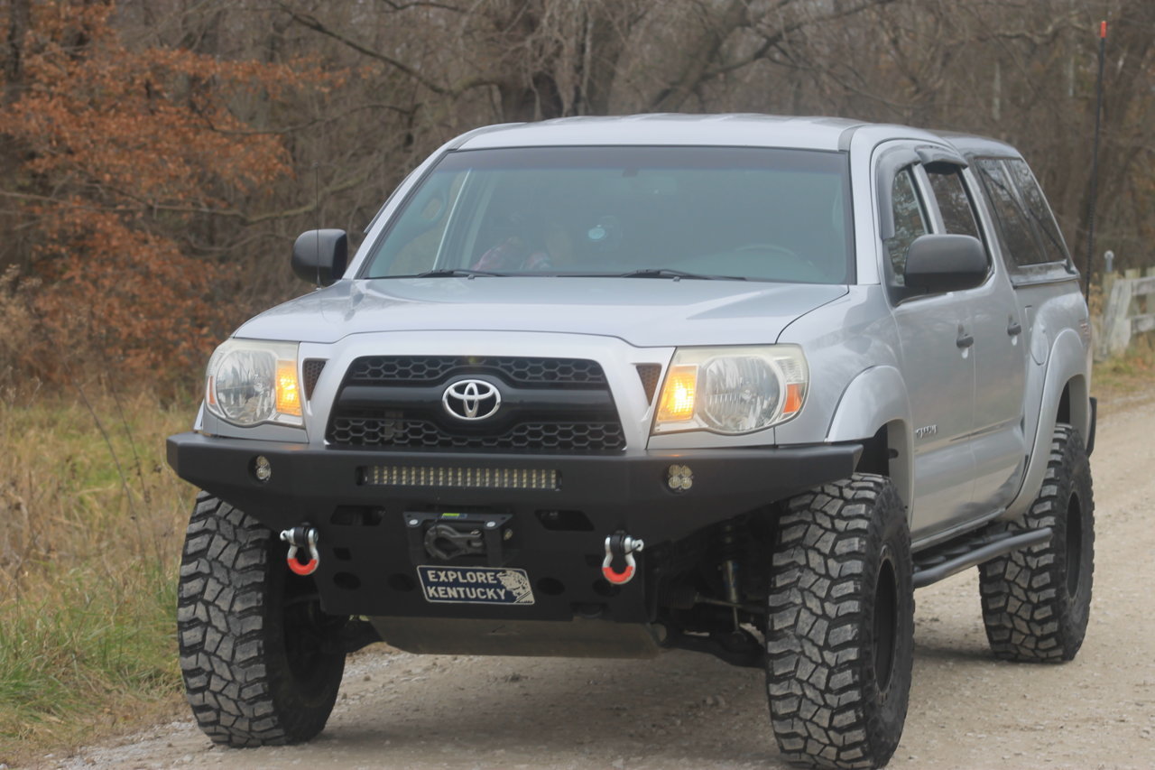

    This is Billstien 5100's (set @ 0") OME 885 coils, Deavers 2" AAL, AllPro u-bolt flip kit, Wheelers Superbumps, 1/2" plate spacer on drivers side/1/4" plate spacer on passenger side. Tires are 285/75r16"'s . Aluminum bumper with Warn VR12s winch, full skids (aluminum) sliders, and ARE cap. With the added weight, it sits 2" above stock on front and 1-1/2" above stock on rear. No aftermarket UCA's but aligns perfect. Rides excellent. Get's wheeled quite a bit. Rest is hwy miles. Best I can measure, less than 1/4" sag over that time. Will do same EXACT thing next time.... About time for new shocks "just because"....
    Lift (Headstrong) was under $800 about 3 years ago. That was 4 shocks, 2 coils, and rear AAL.
    U-bolt flip and superbumps were "extra" and not required....About $400 at that time....
