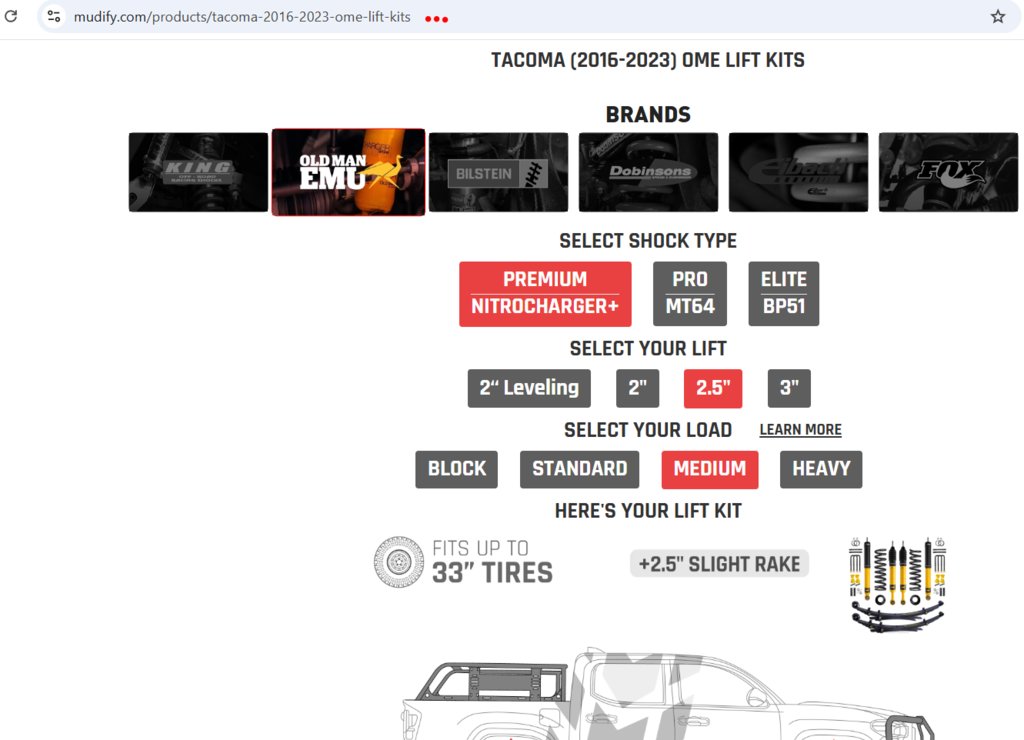

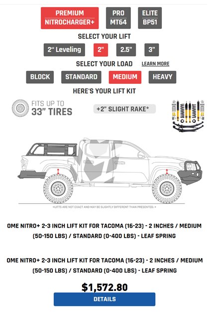

    I think this is what I got, and where I got it. I didn't realize you are in Canada.
    https://**********/products/tacoma-2016-2023-ome-lift-kits
    TheWildMan likes this.
