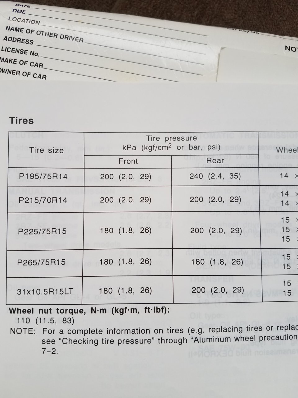

    15403154462699197792751775575031.jpg This is from 1 of my old Tacoma's 26 front, 29 rear.

    26!? Yikes makes 29 not seem so bad!
