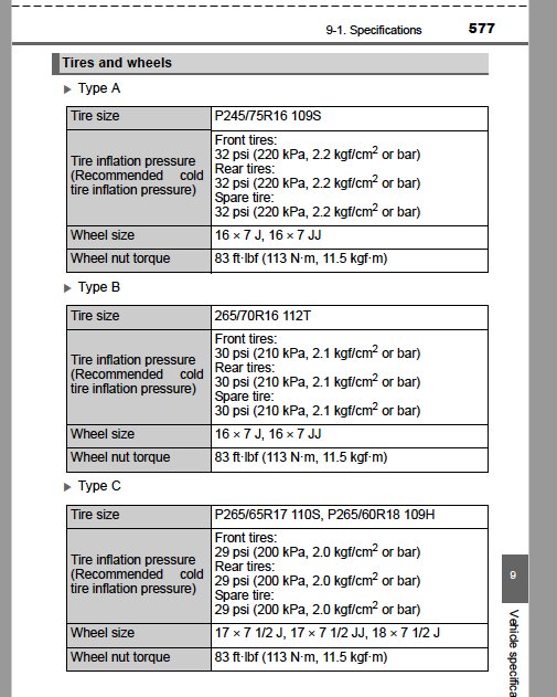

    TOYOTA owners manual says it's C (last one at bottom)

    Type refers to model; tire loads are under "Tire size".
    A is SR
    B is Offroad
    C is Sport; P265/65/17/110S is the stock tire
    ...and I'm not seeing a P265/65/17(P metric) for an AT34S. I do see a 265/65/17/112(euro metric).
    Do your tires have a P prefix?

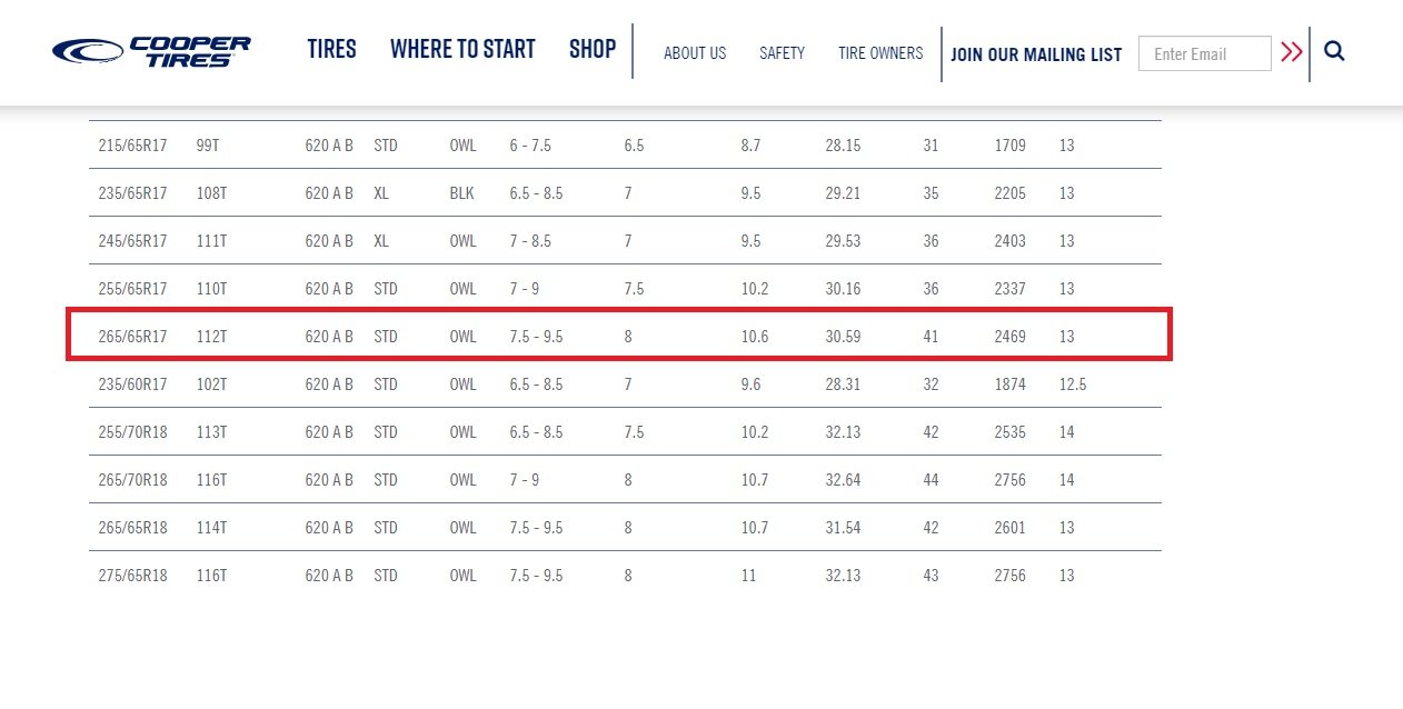

    Well, there's also a 112T standard load on the tire sidewall.
    "A light truck tire load capacity is dependent on the size plus the load rating. All tires of a specific size and load range will have the same maximum load capacity. For example, LT245/75R16 tires have a load capacity of 2,205 lbs. for load range C "
    https://itstillruns.com/dload-ratings-tire-ride-comfort-7606171.html

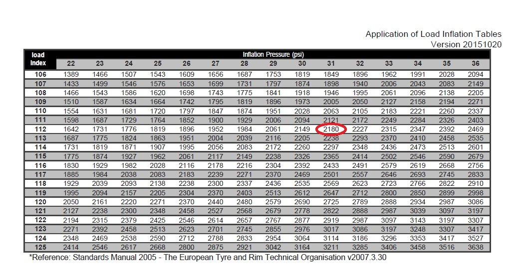

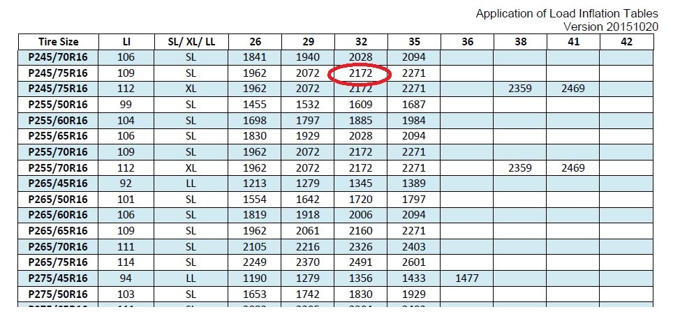

    The OEM tire is a P245/75/16/109S(P-metric) @ 32 PSI giving weight rating of 2,172lb.
    You now have a 265/65/17/112T(euro-metric)
    This gives you a 31 adjusted recommended psi.
    Your new tire tops out on load capacity at 36 psi.
    Anything above or below 31 is personal preference. Which is fine, to a point.
    Above 36 is to maintain speed rating; it's an Autobahn thing.
    But, I do agree with your sentiment of better to err on the side of 'over-inflation'...to a point.
