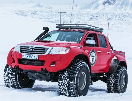

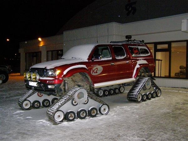

    Get some Mattracks or some real artic tires! :thumbsup:

    Haha those are amazing!! Probably 1/4 price of the truck, but amazing. :eek:
