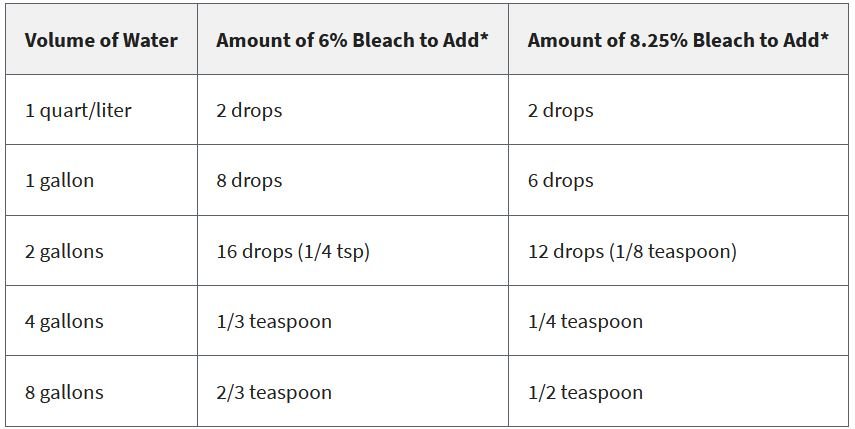

    Don't overthink it, potable water is easy to get in plenty of places. I've lived out of my truck for up to a month at a time on multiple occasions as well as the VW Westy I used to have. In the truck I carry and use one or two of the five gallon Jerry can style water containers (the military Scepter cans are gtg) and secure it to the inside of the bed. It's easy (and cheaper) to refill at water jug filling stations or just buy a couple of larger, 2.5 gal, water containers at whatever grocery you're near and refill from those (the grocery store water jugs are designed to sit on a counter or in a fridge and don't tend to ride well as the faucet part can get jostled open and drip and you need to poke a vent hole in them so plan on dumping them in your larger tank). Buy extra water and leave it in those containers until you need it. When your main container is almost empty, put a little Dr. Bronner's or whatever soap you like in it, shake it up well then rinse it out and refill- easy peasy and only takes a couple of minutes tops. I have never had an issue with this and I've been doing essentially the same thing since the '80s but you could always add a touch of bleach if you were worried for some reason.* I usually add a little bleach to the soapy water mix when I get home and clean them out and let them air dry before storing.
    https://www.epa.gov/ground-water-and-drinking-water/emergency-disinfection-drinking-water
    Ugh, I keep hitting thumbnail and it attaches the whole image. I've tried changing it multiple times- I give up.

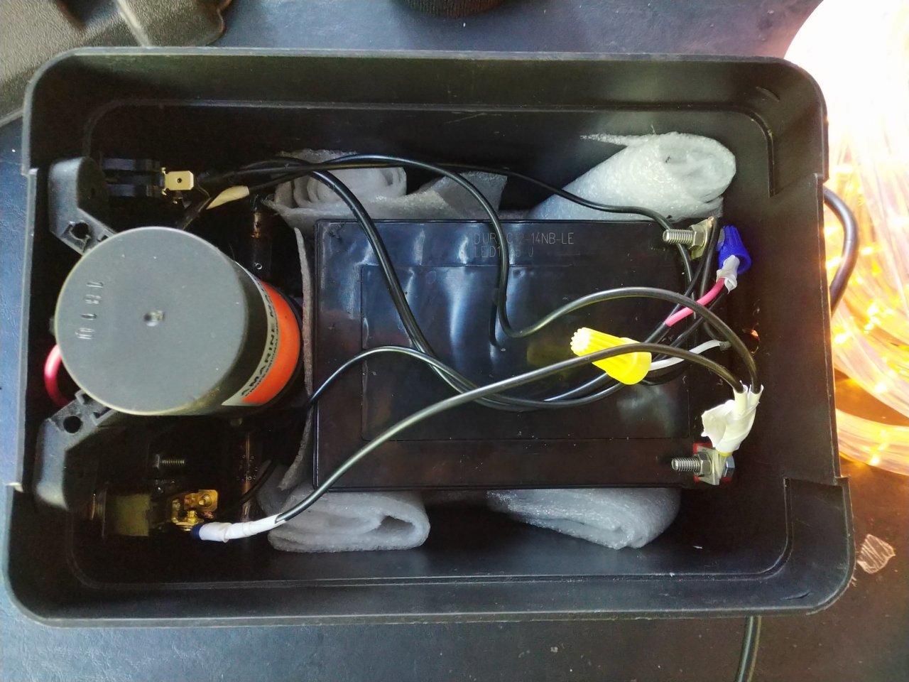

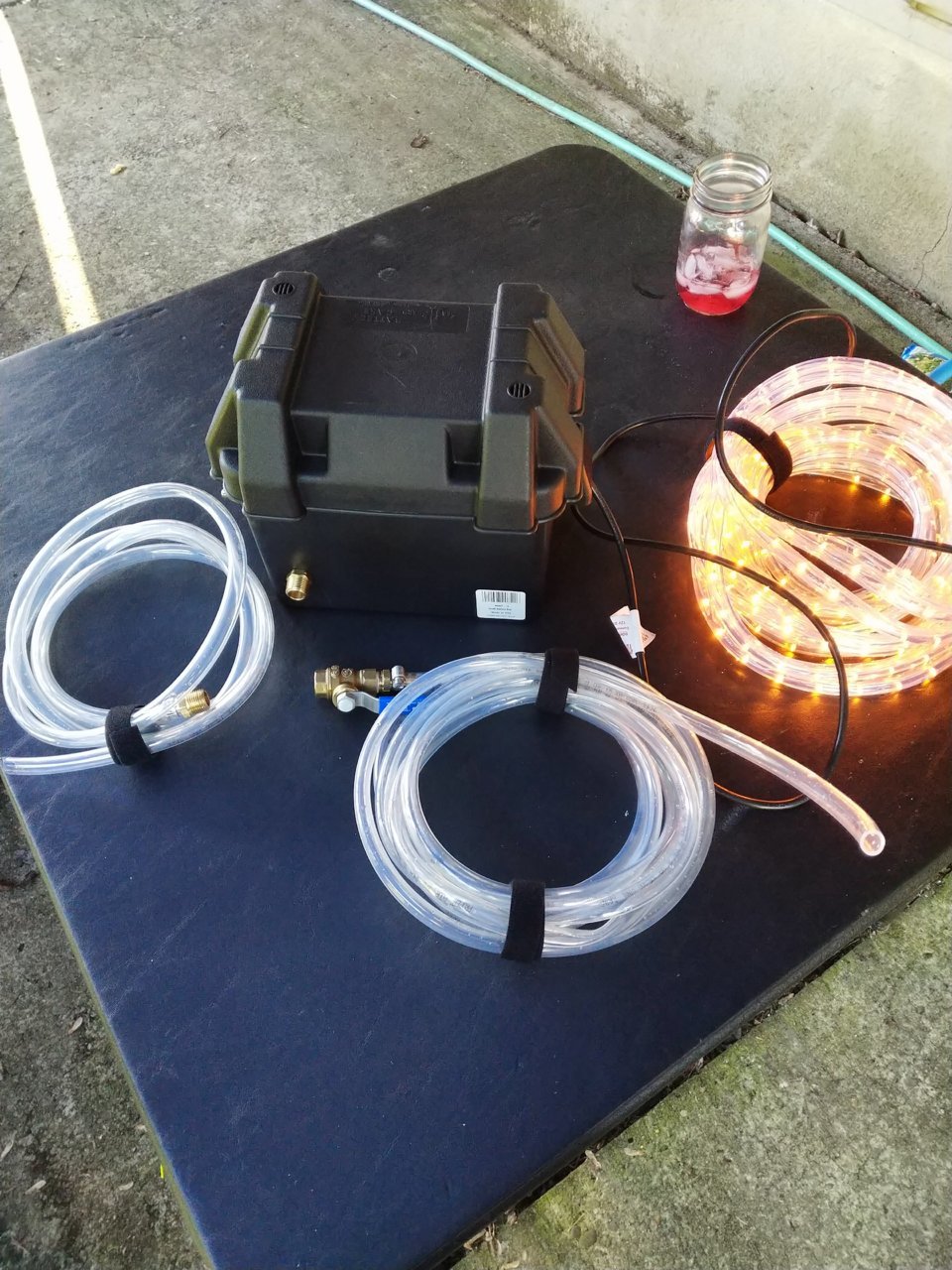

    I built a little camp battery box with a little rv/boat pump in it. I just mounted the pump inside the box with the battery and cut holes for the switch and inflow and outflow tubes. The battery runs some rope lights, a USB charger, and the pump. I keep a little solar panel to help offset the drain. Honestly the pump has been pretty underwhelming. I need to work out some quick connects for the water hose (I just used brass fittings and they either require a wrench to snug up or leak a bit). I have a showerhead and kitchen sprayer attachment for the hose. I clean the hoses and cans with line cleaner (like they use at bars) after every couple trips. Other than my poor plumbing skills it's been a pretty slick system.
    In short, I try to keep all water potable. Water gets added from known safe sources or slowly added using the filter with carbon capsule. Water gets drawn down using the pump or just manually poured out for drinking and dishes. With frigid water nobody ever wants to shower very long or often, but it can be done.

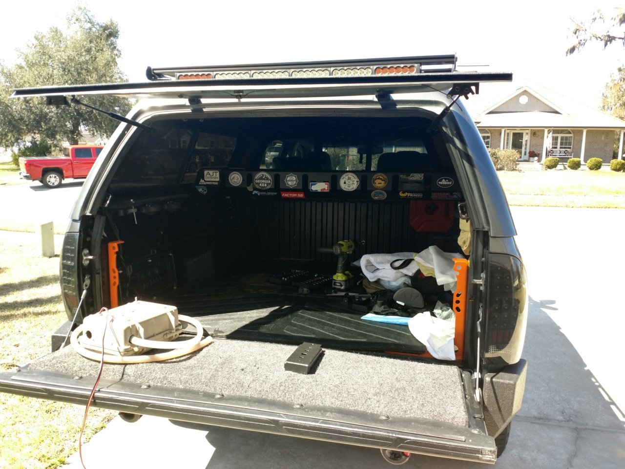

    I have power pumped water in my truck. I can tap into anything which is nice.
    I'm using a Waterport for storage but would like to carry 6-8 gallons. I have two daughters and we go to remote beaches and hike during the weekend. It's great being able to clean hands and feet and gear.
