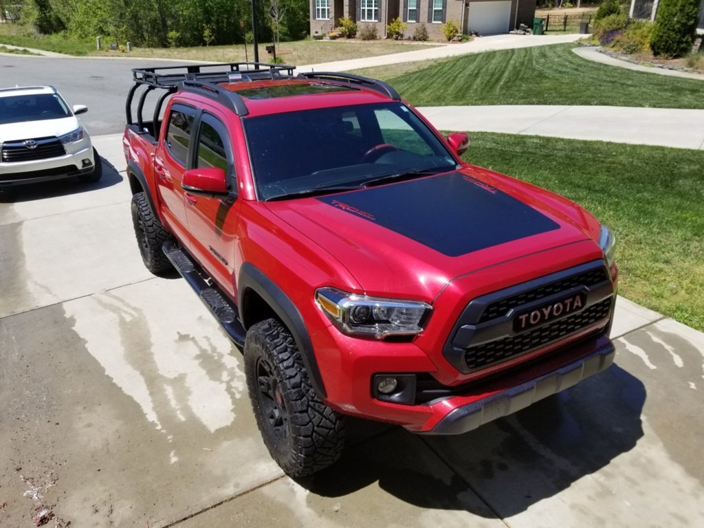

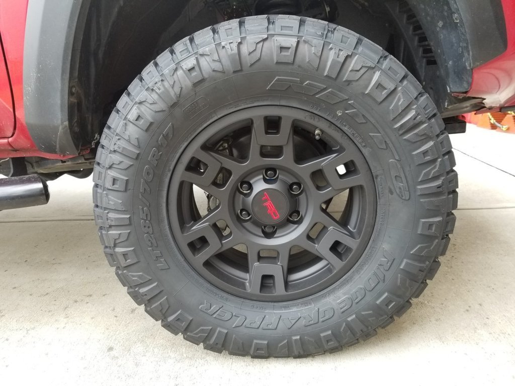

    Spidertrax 1.25" and 4Runner's TRD Pro 17" wheels and 285/70/17 Nitto Ridge Grapplers.

    I like your truck stance.... Have you had any issues with the spacers? do the tires rub?

    Thanks. No issues, I retorqued them after 150 miles. Yes the tires rubbed. I have Nitto Ridge Grapplers 285/70/17 and spent two Saturdays doing a CMC on each side, hammering the pinch weld, and trimming. Worth it though.
    I suspect that without the spacers I may not have rubbed. But once I had them on I could not see the truck with them off.

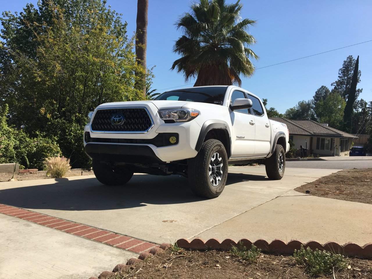

    Spidertrax 1.25" spacers with TRD OR wheels and 265/75R16s. Perfect stance IMO.
