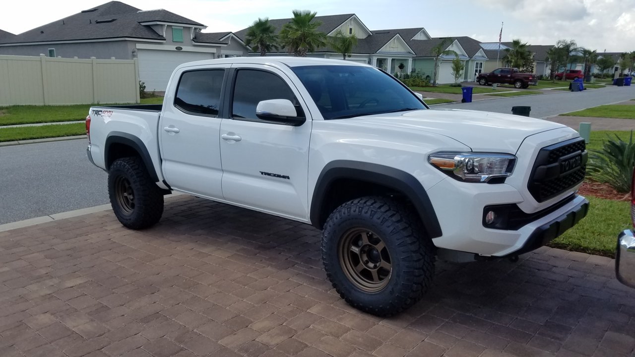

    So do I...I trimmed and heated up the inner fender liner and it still rubs...it also rubs on my cab mount. Whats your wheels/tire specs?

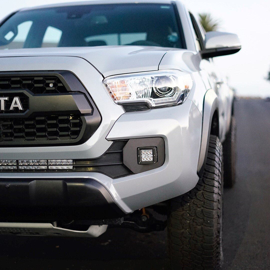

  10. Jun 27, 2018 at 8:37 AM
    #30
    phsycle
    phsycle Well-Known Member
    Aug 22, 2011
    #62149
    1,866
    CA
    Do you have a lift installed as well? Truck looks good, man. I love the stock wheels (dare I say, more than TRD Pro). That's almost the exact look I'm going after.
    motodh likes this.

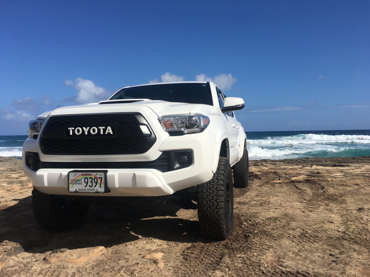

  19. Jul 30, 2018 at 11:28 PM
    #39
    Yotaholic
    Yotaholic Well-Known Member
    May 19, 2017
    #219388
    276
    Oahu, HI
    2017 DCSB Sport 4x4 MT
    Posted my specs, forgot the pics! :thumbsup:
