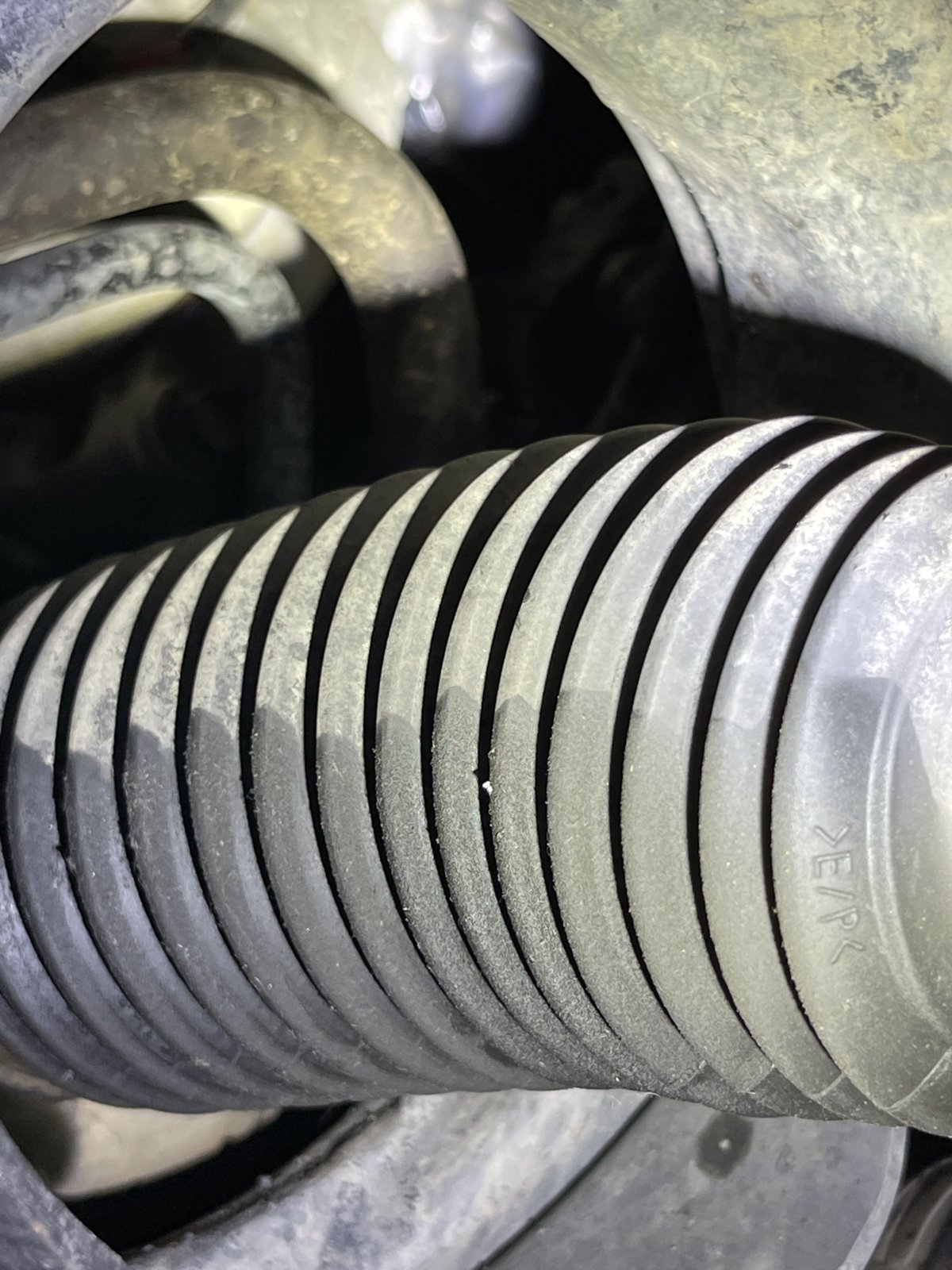

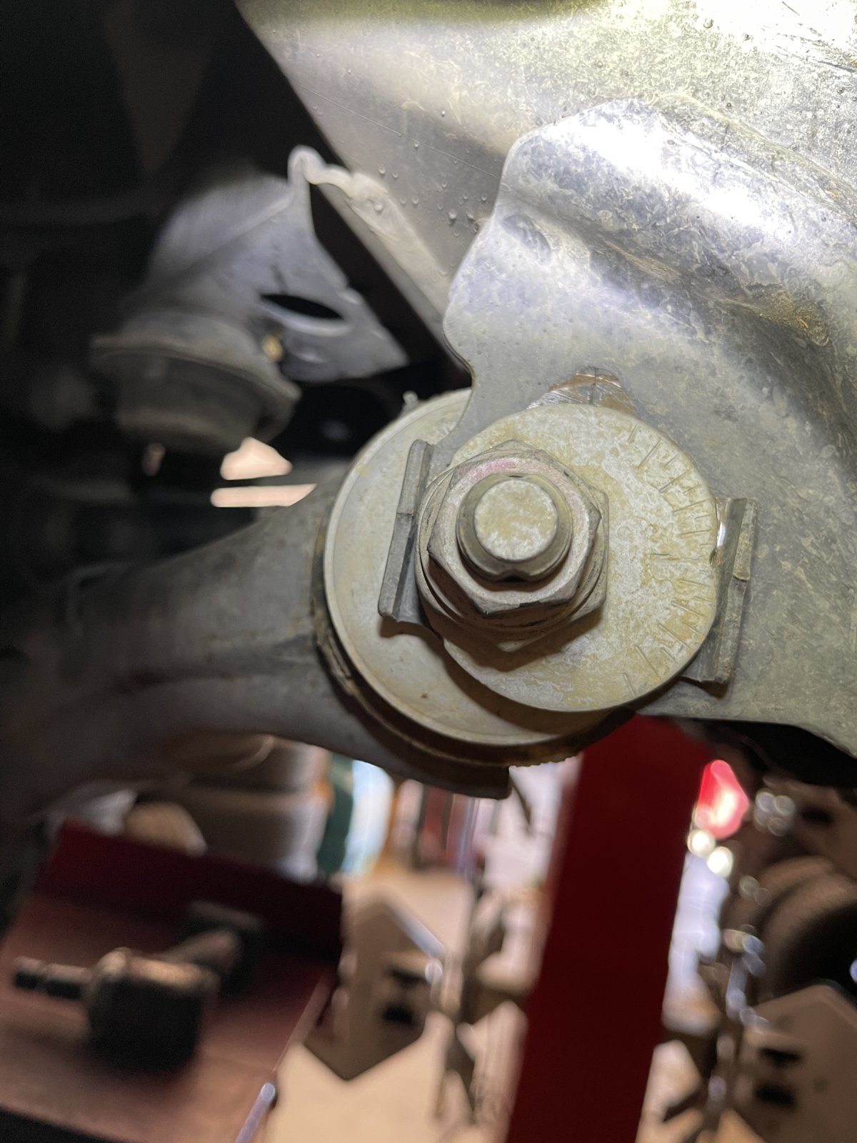

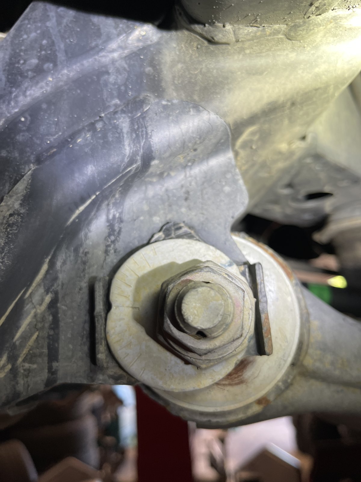

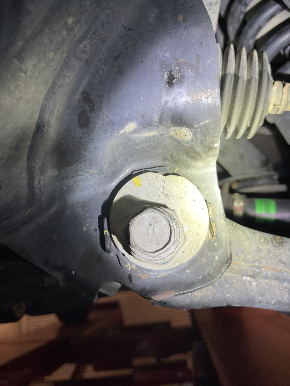

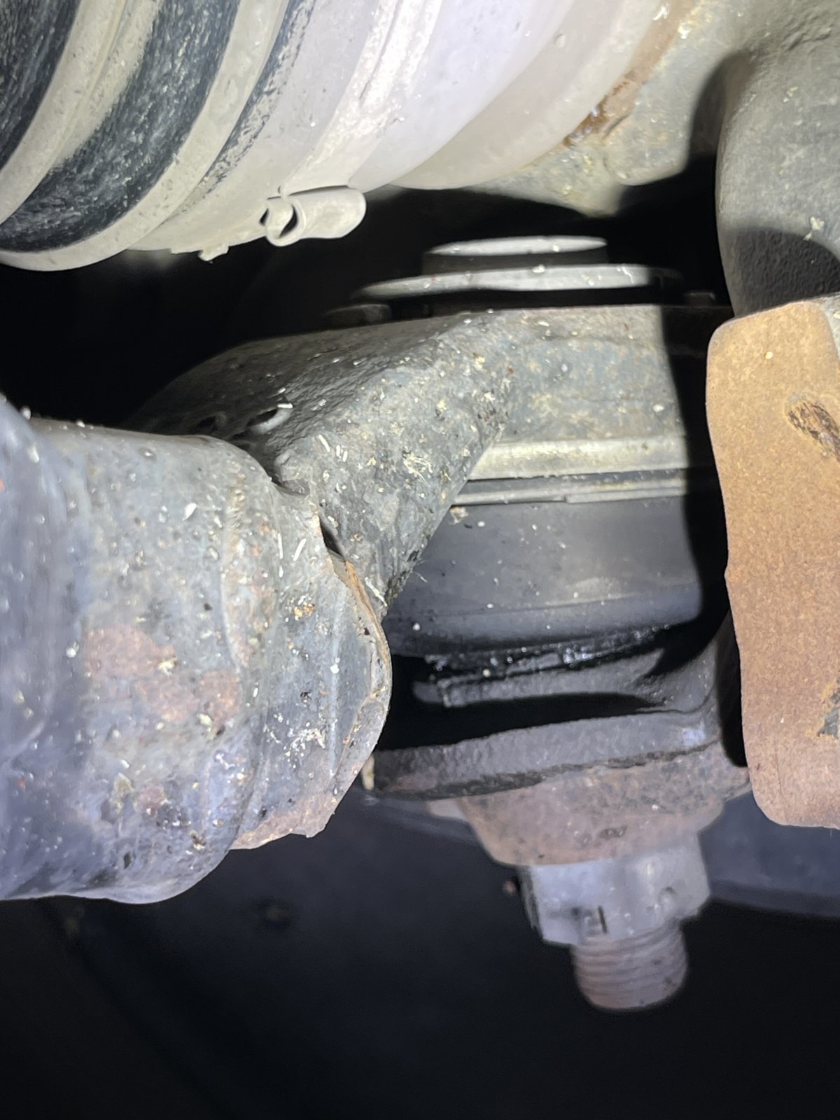

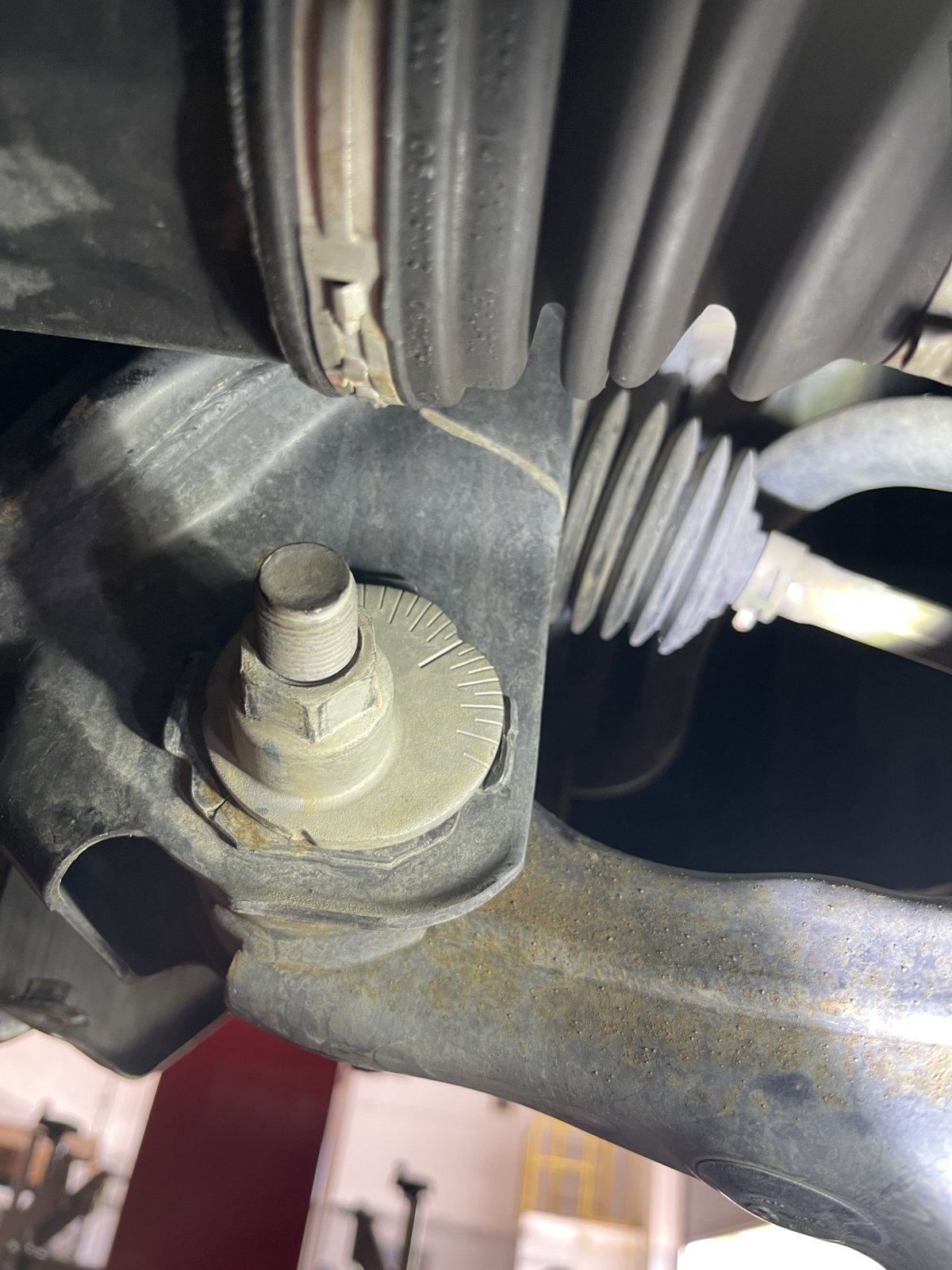

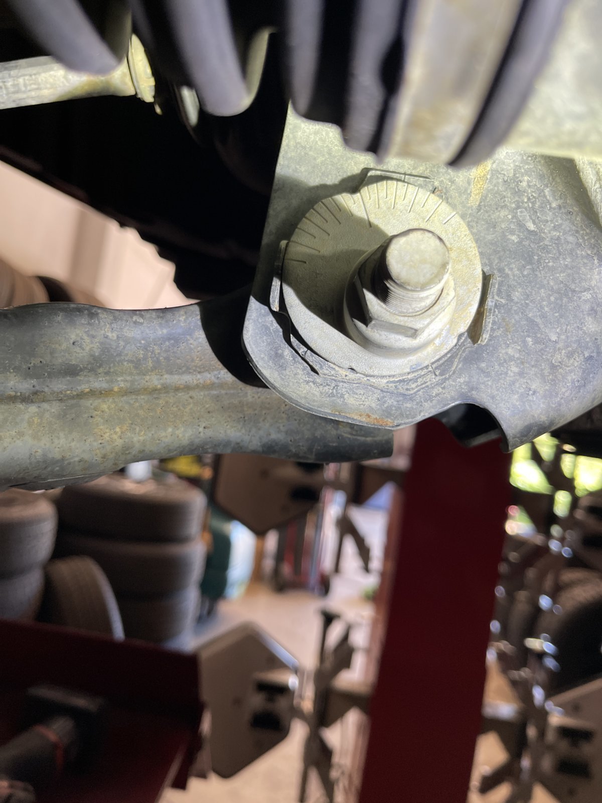

    Got recommended this list by a 4x4 shop in Portland, OR. I dropped it off to get an alignment done because I added the topper to my truck this past Saturday. Unfortunately I can’t get the work done due to having to get back to California and ultimately move early next week (to the east coast). My rig barely passed 50k on my way here from Seattle yesterday. Is this normal wear and tear or has my lift of five years finally catching up to me? I doubt I’ll be able to get any of this accomplished prior to my cross-country move. Any recommendations.

    You'll make it back east.
    But you have some issues.
    Address at your earliest convince.
    Since we don't know how much the Ball joint is worn, I'd put it on the top of the list.
    Then the cam tabs and steering rack, followed by the CV axle / boot.

    tie rod** boots looks pretty "normal" on all the tacomas I've ever looked at...they are always wet....unfortunately. Thats how my ball joint has looked since like 30k miles, at 80k now...no excessive play.
    I'd check all fluids and get an alignment before you leave. The other stuff, I'd look at when you get settled. Just my 2c..
