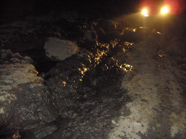

    God I hate hard jerk recoveries nothing says "break something" like a 15-20mph sudden chain snatch.....
    Last time i did one was getting a member out of a mud pit in Corral canyon
    it took 4 or 5 hard snaps to get him out... fucking cringe when i think about it

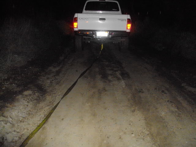

    This was the last one I did...
