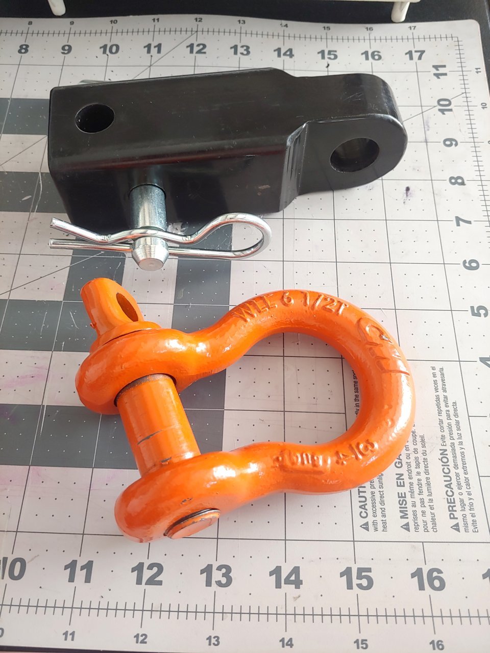

    Those seem awful expensive to me. I picked up this Rigid Hitch shackle mount and a Columbus Mckinnon 3/4" pin shackle from reese-hitches.com. Looks like you can also order them on Amazon now. I don't remember what the wll is on the hitch mount, but it is a solid piece of U.S. steel so I am comfortable using it for anything I would try to pull with my truck.
