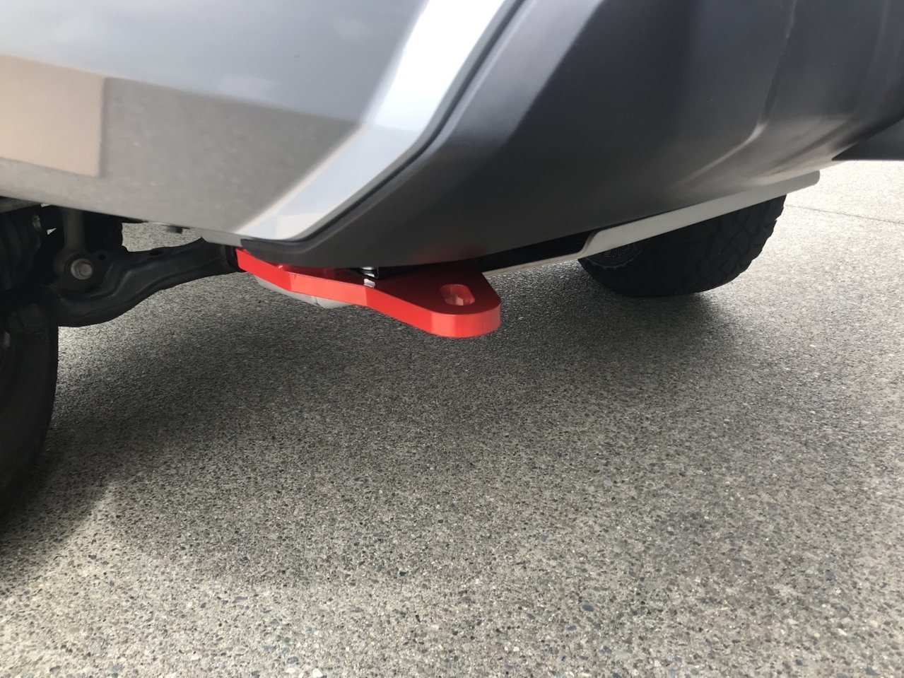

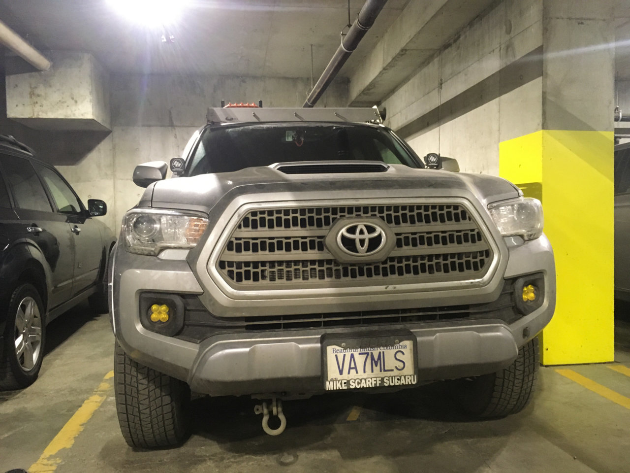

    I've got one similar to the BPF point;
    Understand that it isn't the ARB $250 super-engineered and rated Recovery point.. this is more like the factory bracket made big enough to mount a shackle.
