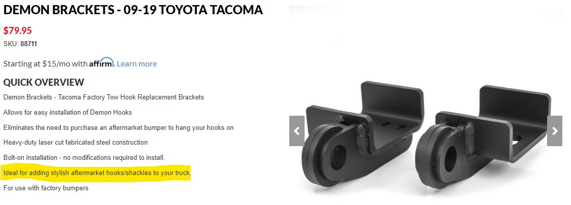

    Buyer beware! Those "recovery" points only connect to the radiator support frame and not directly to the truck frame. These should only be used for "light" recoveries... if that...
    The highlighted note below should tell you all you need to know...

    Technically, I believe it's the frontmost crossmember, pn# 5102104022. But all you have to do is poke your head under the front of the truck and it will be immediately evident it's not something you'd want to be snatching on. As noted in the good ol' manual..

    Yes! That thing. I questioned my "radiator support" name... but was at a loss of what it was actually called. Regardless, you yank on it too hard, and you're gonna have a bad time. Which is actually the opposite of my standard advice.

    It would be easy to mistake it for a radiator support. It's not much beefier..
