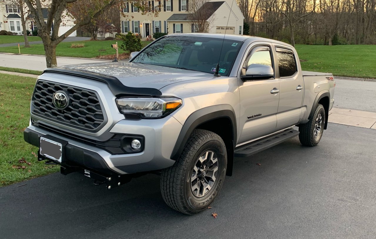

    I went with the Draw-Tite Front Receiver. Attaches to the frame at multiple points and has a higher rating than the Curt.
  8. Jan 25, 2021 at 11:02 AM
    #48
    PThy
    PThy Well-Known Member
    Jun 13, 2020
    #331341
    158
    Pat
    SoCal
    2020 TRDOR MT
    Do you have picture of it installed?
    Thanks

  10. Jan 25, 2021 at 11:08 AM
    #50
    PThy
    Jun 13, 2020
    #331341
    158
    Pat
    SoCal
    2020 TRDOR MT
    Thanks Al.
    Oh yeah it does. No thanks.
  11. Jan 25, 2021 at 11:11 AM
    #51
    Doc62
    Doc62 Well-Known Member
    Nov 7, 2020
    #346138
    612
    Dave
    SE Pennsylvania
    2021 Tacoma TRD Off Road, 2019 Sahara
    Here it is.

    Thanks Doc
