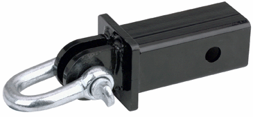

    I'm picking this one up at Harbor Freight this week.
    $12.99
    or $19.99
  12. Jan 25, 2010 at 10:47 AM
    #32
    Veccster
    Veccster [OP] bass turds
    Aug 8, 2008
    #8407
    2,181
    Eric
    Pittsburgh - The City of Champions
    2020 Pro
    Do you have a need for different size balls? Do you really foresee the need for that hideous thing on the back of your truck?
    I like the 2nd harbor freight option. It's not for a heavy duty use but it'll be there if you need it. And cheap to replace if it gets stolen.

  18. Jan 25, 2010 at 12:08 PM
    #38
    derekAV
    derekAV Well-Known Member
    Nov 14, 2009
    #25921
    568
    derek
    Humboldt
    2000 4x4 reg. cab

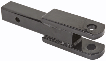

    i would not trust thoes welds..

    Glad I could make you laugh a little. In all seriousness I can't say it's a bad product, but to make an academic point, I would not use it because I would want my receiver to be solid metal like the warn receiver.
    The crippler from the pictures shows that it's hollow, and therefore not as strong. But to each his own, if you really like it then that's what matters most.
