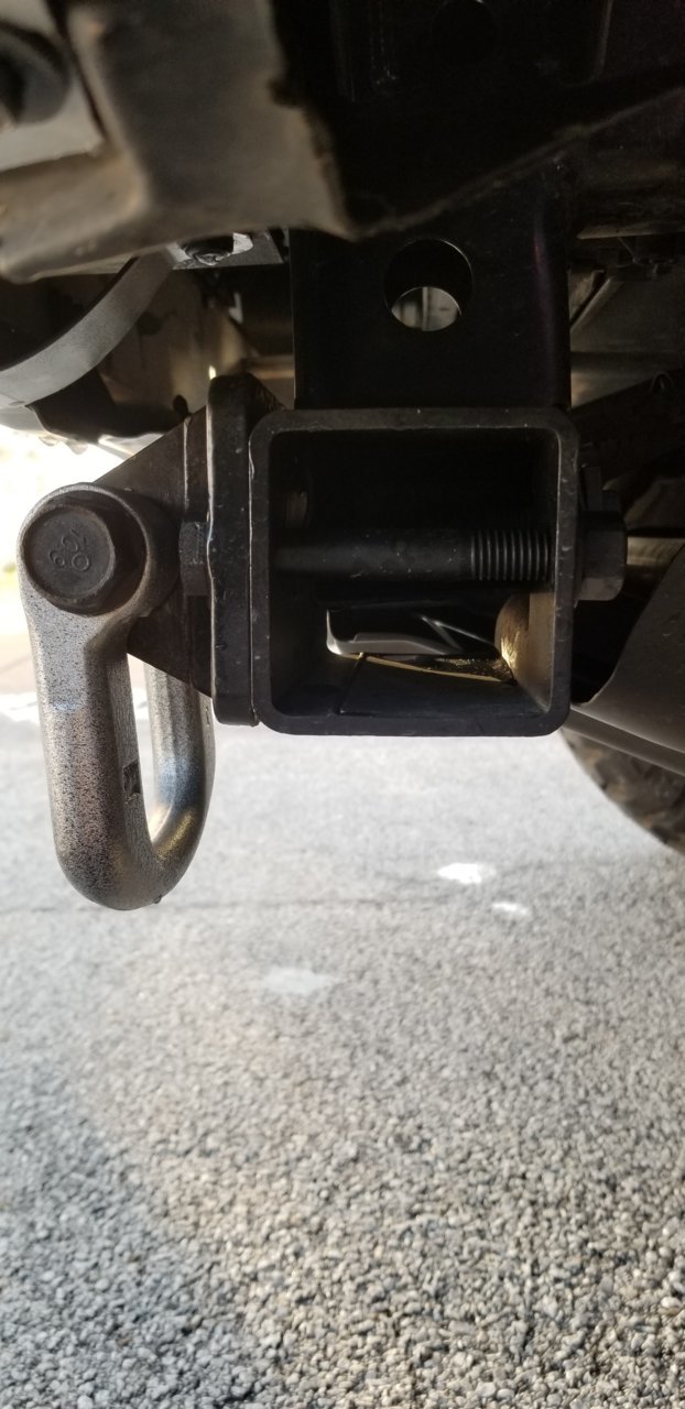

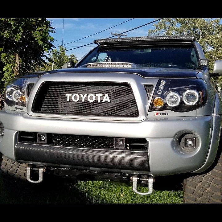

    Just finished installing my recovery tow hooks. These came off a 2009 Hummer H3. Took some time to figure out where to locate them and how to add brackets for the installation but I'm happy with the outcome.

    Looks beefy for sure. Did you have the mounts welded to the frame?

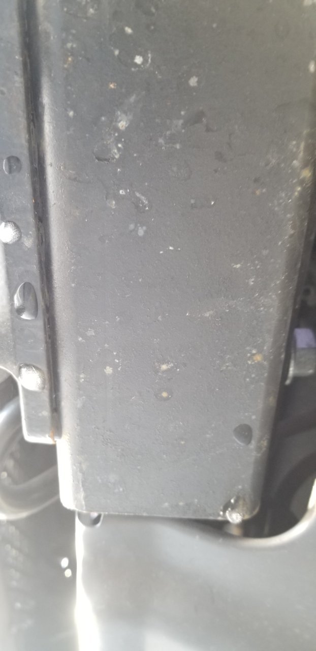

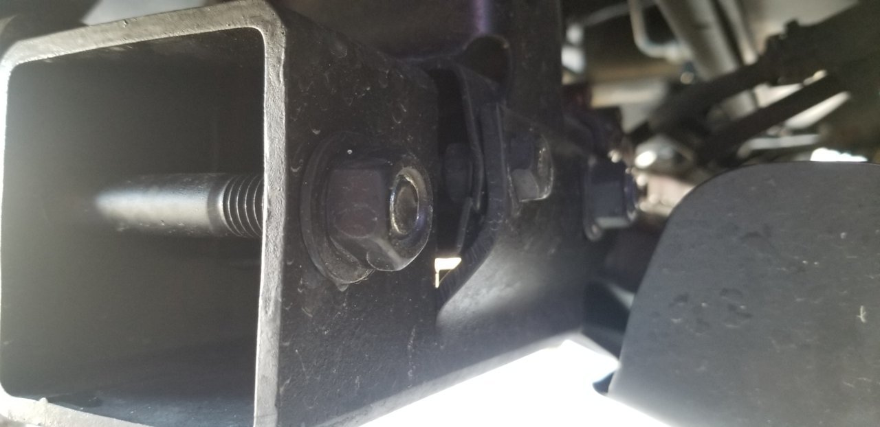

    I didn't weld them to the frame I bolted them for now because I wasn't sure if I would leave it this way but so far I really like it. I may end up leaving the bolts in but also welding for added security. I used square stock at the bottom where the frame sticks out. Originally the frame had metal extensions that stuck out that bolt in to this lower bumper section. When Toyota replace the frame they left them off, I didn't even notice until I did this mod. I guess it's too late to get them back. I decided to use square stock to slide over the existing metal but it wasn't quite wide enough, in the picture you can see that I had to cut into the square stock then I heated with my torch and bend it out a bit which I didn't want to do because it weakens the steel but I still believe it will work if I needed to use them. I could definitely get more strength out of it if I welded it to the back side where the square stock slips over. I do have 3 bolts going through, 20191101_083515.jpg two are pretty heavy duty they are1/2 inch in size.

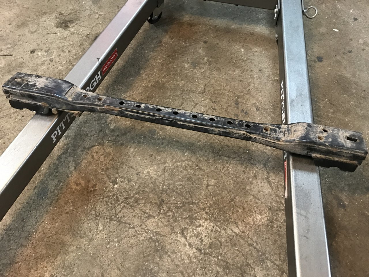

    I don’t want to burst your bubble, but that “crossmember” that you have those bolted to will not stand up to a hard pull.
    First of all, it’s like 1/8” thick. Then, in the middle it is necked down and perforated. It is obviously meant to crumple in a collision.
    Just trying to save you a headache. I bent mine coming down on a rock on a trail. It has since been cut off and rebuilt way stronger.

    Yeah it is very thin but I noticed when I was drilling through it that it was eating up my bits. I believe it is heat-treated but I could be wrong. I was able to drill through the square stock much easier and it was probably 3/16 thick. I believe I would be able to do some light pulling with them but as you said probably would buckle under a heavier load. If you noticed they welded the factory recovery hook at this location so it should withstand some pulling.

    @Tacoforever I’m sorry. I really was just trying to give you a friendly warning. But I have to just make one more point, and then I’m out.
    And I’m not trying to detract from your mod here. It looks neat, and I’m sure it’ll hold up to anything that isn’t ridiculous.
    But...
    This is what that crossmember is:
    If you want pull full size trucks out of sand with this, more power to you.
    It is the weakest point up there to do so with. It is obviously meant to crumple.
    There is a reason that people use frame tie ins with plate bumpers and front receivers.
    Because these frames get tweaked if pulled on too hard. And that’s when being pulled on directly at the front frame horns. Which is way stronger than that “recovery point”.
