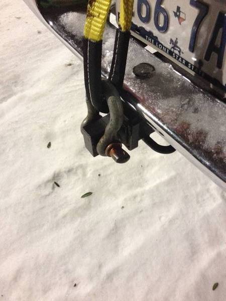

    Standard shackles like you would see on an off road bumper would be 3/4" or some like to use 7/8 for added strength. This is not a place to skimp and buy cheap chinese shackles. You can get good CM brand ones off of Ebay for cheap. My 3/4 CM is rated for 14,000lbs vs chinese one at 9000lb. Iron man and ARB straps are great for stuck vehicles. Smitty built makes nice cheaper ones for towing and ligh pulling. A reciever shackle is a great recovery point in the rear. Obviously tow hook in front if possible. [​IMG]

    I have only been able to find like 20' recovery straps? Does anyone make shorter ones? Additionally, when using a recovery strap is it best to use a shackle from the hitch receiver instead of the safety loop hooks?

    A shackle in the rear receiver is best followed by the OR's front tow hook. The front loop is just a transport tie down point?

    You can feed the strap loop into your trailer hitch receiver and use the pin to hold it in place. A receiver shackle would be better since repeatedly using the pin method would probably fray the strap. For shackles I like Van Beest or Warn Epic. The kinetic recovery strap I prefer is an ARB.
