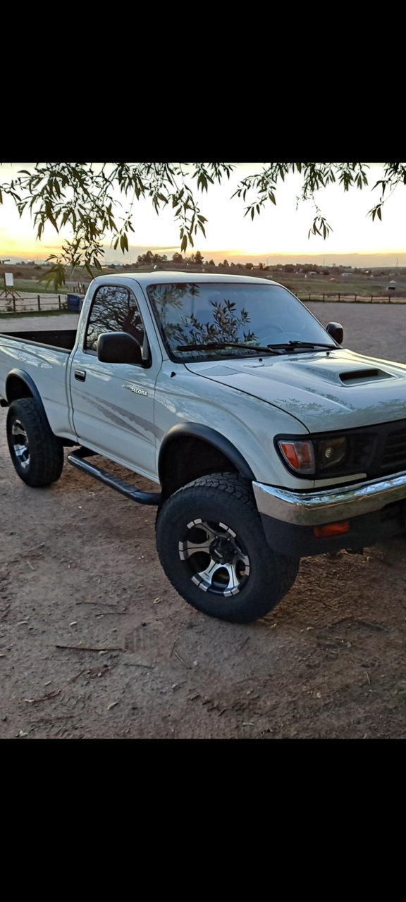

    Really need photos,

    :boink:Uhhhh, I think that the picture that was called for was of the antenna or its box, or its receipt. Not of your truck. But WTF do I know...

    He was showing OP the antenna delete

    Your late to the party,OP wasn’t sure if he want an aftermarket electric antenna,
    So the photo I posted is my aftermarket electric antenna and what it looks like in the down position
