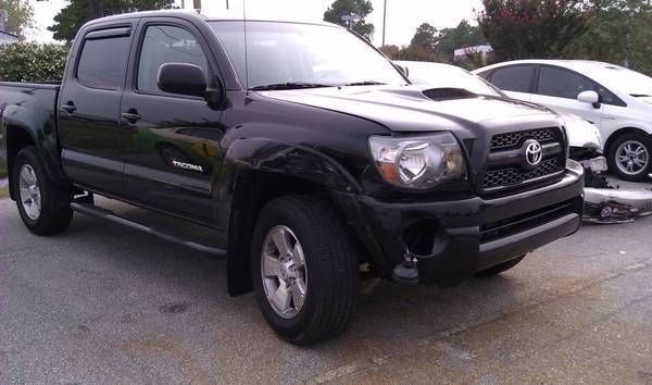

    The issue: Having to rebalance tires after almost every tire rotation
    Side Effects: Steering wheel shimmy around 60mph and tire cupping
    Truck Description: 2011 TRD Sport 4x4
    Oil Change/Tire Rotation Schedule: Every 5,000 miles
    Driving conditions: Coastal location, 70 mile round trip commute M-F cruise set on average at 70mph, off road on Sand 10-15 times out of the year and on Snow 1-3 times out of the year. :burnrubber:
    Timeline:
    September 2010 Purchased Truck, brand new, with every mile to my name.
    August 2011 Major accident. :( Not even a year yet, damn! :facepalm: Got hit directly into the right front tire and it shifted my entire front end. :censored: I about beat a bitch. :smack: 4 weeks later I got my truck out of the body shop with suspension, tire, wheel, power steering, alignment and more major parts replaced. Truck rolled like nothing happened for a while, I some times have a strange phenomenon with power steering but that story is for a different time. :rofl:
    The Damage
    March 2012 New set of tires installed. Stock spec’d, 265/65R17 Goodyear Assurance CS Fuel Max.
    November 2012 Out of the blue, first rebalance needed… I remember getting my oil changed and tires rotated like I normally do, but when I took off down the highway and got to 60mph my steering wheel began to shake. I took it back to the garage to have them balance and they stated that 1 front tire was imbalanced. I kept in mind that the tire was on the back before the rotation, so it could have been imbalanced for a while and I hadn’t noticed until it got put up front. Still, after getting that 1 tire balanced, I started having to get my tires balanced after almost each tire rotation from then on out.
    January 2014 I notice all my tires are cupped :eek:… with all the bouncing, what would you expect, right? Because of this, my garage decided to check the alignment (though I had no side to side pulling) but no adjustments were needed. We only briefly chatted about suspension being an issue but chalked it up to imbalance and my tires being low-end.
    March 2014 I started using a different garage, still the same issues occur with balancing.
    April 2014 New set of tires installed. Bigger size spec, BFG All-Terrain KOs at 265/70R17. Got them balanced during the install and got my truck aligned… still though, after each tire rotation I discovered a shake at 60mph. As always, I get my tires balanced and I’m good to go until I rotate again.
    Theory: I’m leaning towards the suspension but I am up for any other interpretations. The fact that I had so much work done to my front end after the wreck brings me to that suspicion but I have had no other issues such as alignment or anything beyond balancing.
    Game Plan: I just had an oil change and tire rotation a couple of weeks ago at my garage. Sure enough, I took off down the road and started feeling a shimmy after 60mph. I decided to take my truck to the dealership this time and have them balance the tires instead of my garage. Toyota had to balance all 4 tires from what they reported and then also noted that I still had a slight bounce due to the size of my tires. I plan on taking my truck back to the dealership once I’ve driven 5,000 miles and have them re-check the balance on my tires. I am assuming that at least the front tire(s) will be out of balance. From this I guess I can narrow down what the cause is but I can’t say what it could be further than general suspension issues. What do you guys think? :confused:

    Maybe you have a driveline vibration of some kind. Not saying it is, just an idea. Some tires are just a bitch to balance. Mine won't balance. But you've gone through 2 set with the same vibe issue. Do you have the balance sheets?

    Have you ever thought about having the 'frame' checked ?
    And I mean..... you had a 'major accident' in the front end, the frame could be slightly tweaked/twisted/bent. If there's a problem with the frame, there's nothing you can do to 'over-come' that (other than fixing the frame itself).
    Just a thought.....

    I have not been collecting the balance sheets, unfortunantly. :( I am normally great on keeping paper work but have failed to insist on getting the read outs for this. I will start from now on though. I think keeping the Driveline in mind is a great consideration! I am getting a list of key components together to read up on so I can make sense of their operation.
    I didn't even consider the frame being bent. :eek: Though that sounds horrifying, that could definitely be the underlying issue (I was hit hard!). I don't know the logistics enough, but could it be that if the frame was bent that it could slowly started putting all other eliminates out of alignment and thus cause imbalance? I didn't start having balancing issues until a little over a year later from the accident.

    It would depend on how much and where the frame is bent. It could be tweaked or twisted, it could be shifted side to side, or literally bent in the front. Who knows.... Slight or not so slight.
    My first gen truck hit the ground hard offroading at one point...and it knocked something out of whack. Toyota could get it in allignment specs - but the one side (settings) was maxed out to get it within spec. The truck ran fine for a long time....until I started noticed cupping on the inside of the tires.
    It's worth a look......

    Let's review ... before the OP starts paying mechanic more money to 'look at the frame'...
    Runs great.
    Rotate tires and it vibrates .
    Tire wear is uniform.
    Mechanic has tires rebalanced every rotation.
    Mechanic causes OP to worry about discussing it.
    I wonder if the tires and/or wheels might have been improperly mounted?
    Or, a poorly balanced tire on the back got rotated to the front?
    Or, she needs a new mechanic?
    Wouldn't those be the easiest explanations?

    Something you could try at home to check the frame.... This is a redneck method - so, it won't necessarily pickup on any 'fine irregularities'.
    I did this method on my Jeep that was in a rear-end collision that was totaled. We bought it back from the insurance company and thought we could rebuild it, until ....discovered the frame was bent.
    Basically, you're making a couple plumb bobs with magnets (strong), string, and some lead weights (fishing weights?). After you make the plumb bobs - put the magnets on opposite corners (on the frame). The string must be long enough for the plumb bobs to almost touch the floor. Measure the distance between the two plumb bobs. Then...put the magnets on the opposite corners - making sure they're in the EXACT locations as the first run. Measure. Compare measurements. You get the idea.....
    I don't know what 'out of spec' would be - but at least it'll give you an idea of how close they are (or not).
