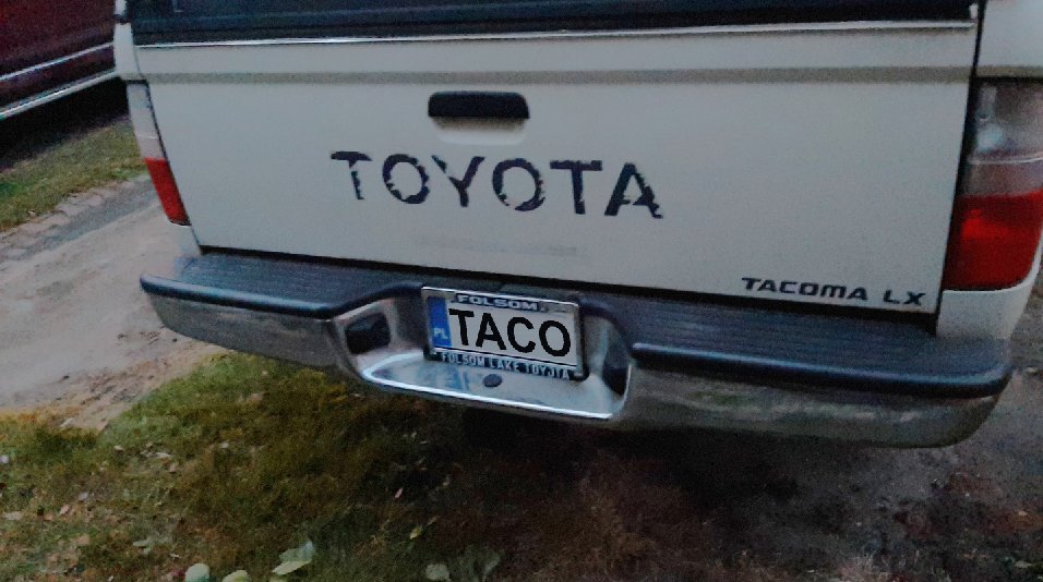

    That is correct. All cars require red reflection markers on the rear. But even if you add the red stick on reflectors, that white reflector is not good. There should not be white reflection on the back.

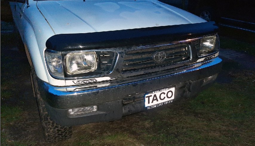

    By the way the same issue is with my all clear front markers.
    They are not legal in USA as front markers must have orange (amber) reflective inserts. But I did that swap on purpose - I took the truck to Poland where front markers must be all white including reflective inserts. Orange markers or inserts are not allowed in Poland. As for the rear lights Tacoma meets local requirements (orange blinkers behind clear lenses and red reflective inserts). With all white rear lenses Tacoma would not pass annual inspection in Poland.

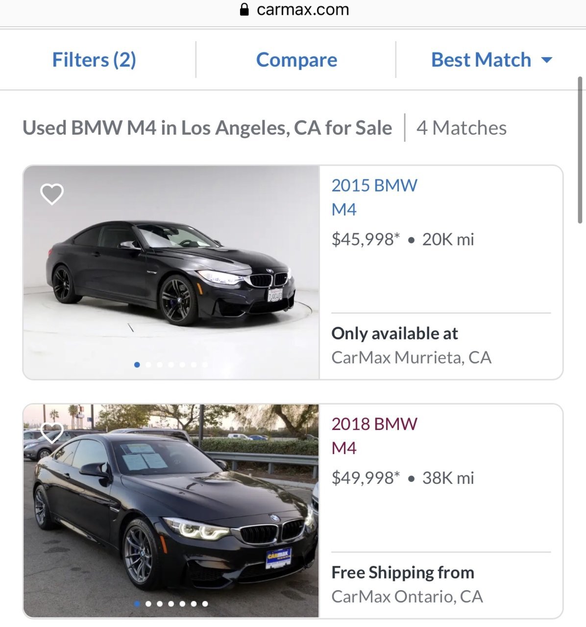

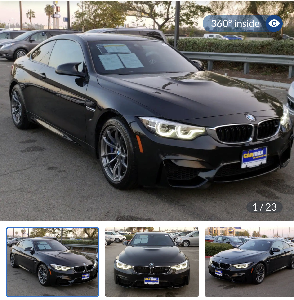

    To my understanding they do not need to be together as one light assembly as long as the light is the correct color for the application also not sure about the white reflector I will be doing some research later but to me they are clear reflectors just like yours they still would be the color of the bulb when you turn
    look at this stock bmw being sold in Cali the bulb is in the headlight with a orange reflector on the side

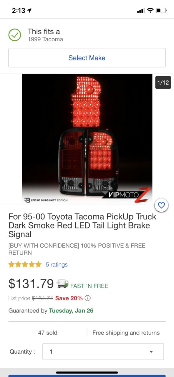

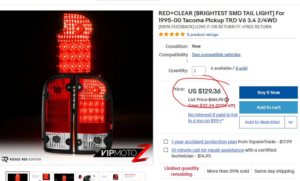

    Can you post a link or brand? I want to see if they have a 1999 option. My OEM are worse for wear.
  4. Jan 19, 2021 at 2:09 PM
    #44
    Sicyota04
    Sicyota04 Slowly but surely.
    Jan 9, 2015
    #145940
    3,561
    Morgan
    California
    04 DC 4x4
    Let me see. I still gave them in the truck. Installed in 2016.
    Looks like EBay has/d them
    VIP MotoZ is the store or brand on there

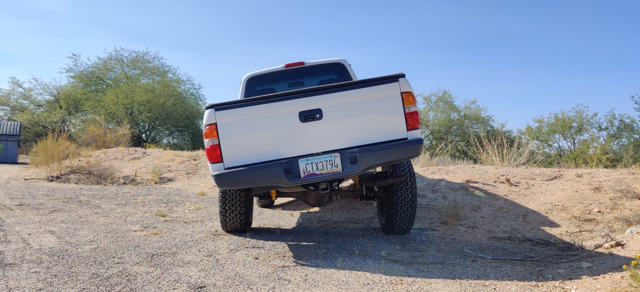

    Finally got mine installed and swapped with LEDs and I think they look far better than stock.
    slodoug likes this.

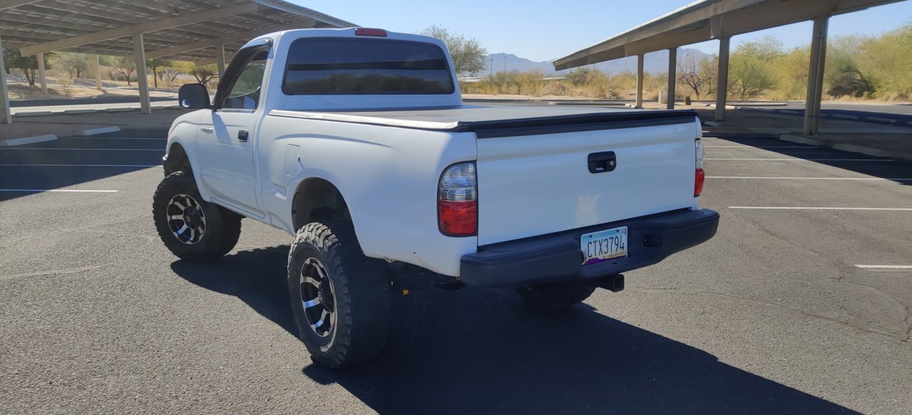

    I have a pair on my 96 and also my 0320210206_193317.jpg 20201018_130619.jpg

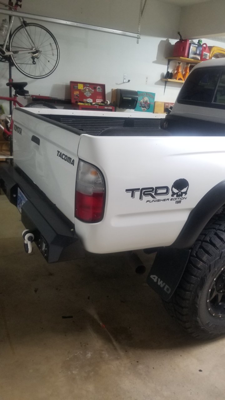

    Hey... Nice rear bumper. Where did you get that lol?
  19. Apr 14, 2021 at 10:39 PM
    #59
    Tacomahawaii808
    Tacomahawaii808 Member
    Dec 31, 2020
    #351218
    13
    #59
  20. Apr 15, 2021 at 10:45 AM
    #60
    Sicyota04
    Jan 9, 2015
    #145940
    3,561
    Morgan
    California
    04 DC 4x4
    Trail gear rock defense rear bumper & sliders from 4WP
    Then the front TG front bumper from ORW
