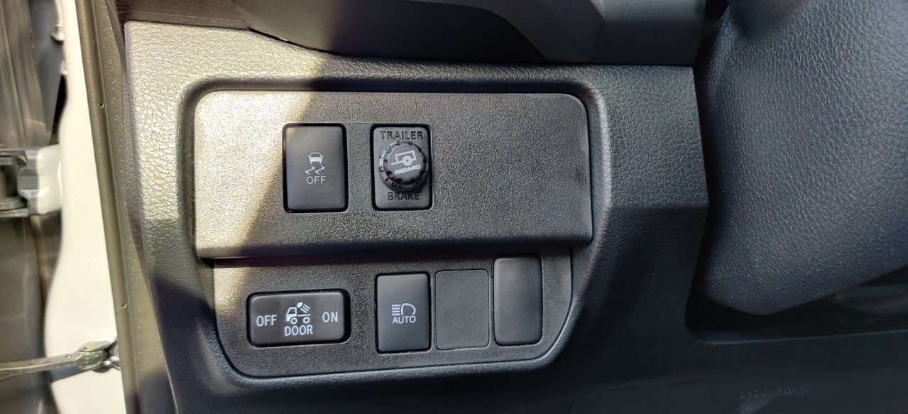

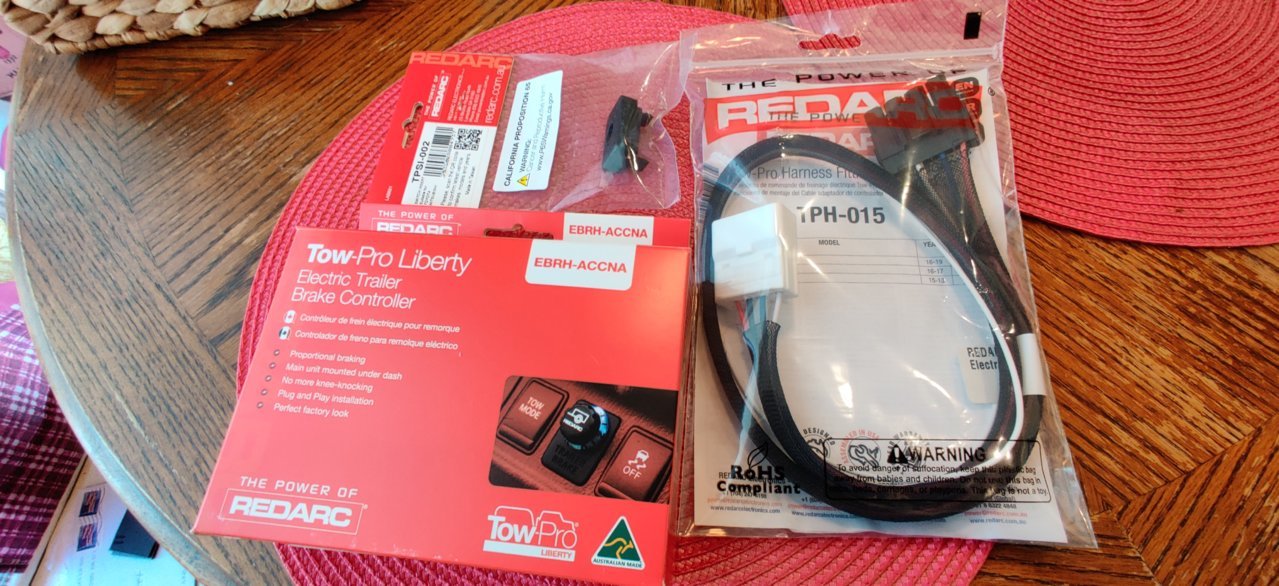

    I just installed the tow pro liberty a few weeks ago. You need the tph-15 harness, and the tpsi-002 button insert. If you choose the Liberty over the elite you should know that only the elite model comes with a universal harness you can splice in to. The Liberty doesn't include any harness, just buy the custom harness I listed to go with it and it plugs right in.
    It will look like this installed in the dash
    TowPro Liberty
    https://redarcelectronics.com/products/tow-pro-liberty-electric-brake-controller
    Wire harness
    https://redarcelectronics.com/products/tow-pro-brake-controller-harness-to-suit-toyota-tph-015
    Button insert
    https://redarcelectronics.com/products/switch-insert-to-suit-toyota-mitsubishi

    Thank you very much to both of you!!! I’m so glad to know there is a solution where there are plugs at both end — will save a lot of time with no splicing!
