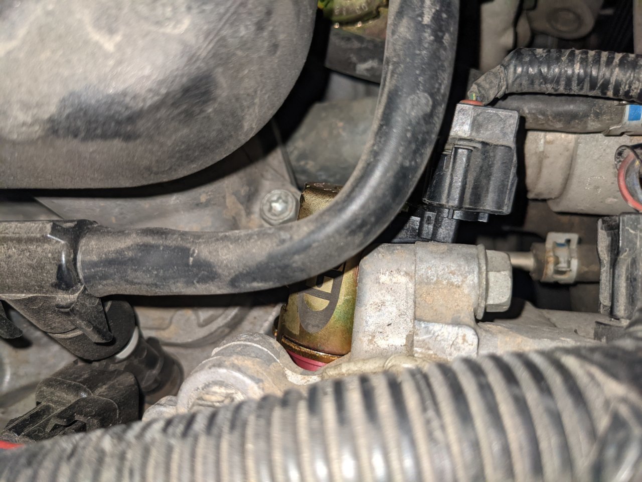

    Anyone have a picture of where this is at on the truck?

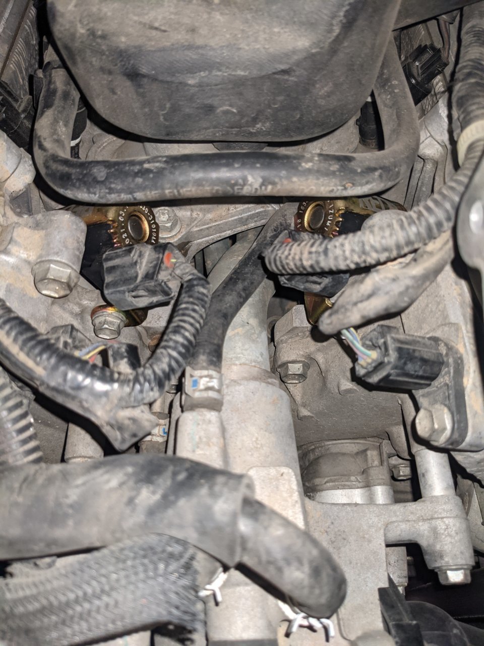

    2C7BC8FD-DA39-4D38-BE79-FC14AC2C8A77.jpg In the red circles

    Very accessible when you remove the throttle body.

    Wouldn’t take too long to get in there. I snagged a pic a couple weeks ago doing some cams gears on a buddy’s truck and forgot to post it here. I’m definitely interested in how these work out.
